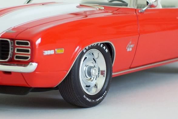

Does the fender area that you want to apply the foil to have molded on trim? If so, and assuming it's the molded trim that you want to be chrome:
example: is this what you want to accomplish?
http://i5.photobucket.com/albums/y197/justdande/Completed%20Model%20Cars/1969%20Camaro%20Convertible/000_0750.jpg
Apply the foil as a large enough piece to more than cover the molded trim, burnish the foil down nice and snug working it into all of the corners and crevices then with very light pressure and a very sharp (new) #11 blade trim along the molded surface and peel away the excess foil. This should leave foil on the area that you wish to have covered. Last, using a soft cloth, go over the foil again to make sure the cut edge is pressed down nice and smooth.
Be careful, there is always a risk of the knife slipping and cutting into your paint but this is a risk that comes along with the use of BMF. Practice will make you feel more comfortable with it and little mishaps will happen less often over time.
