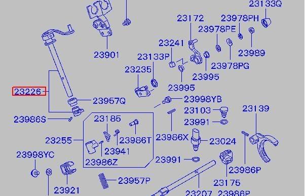

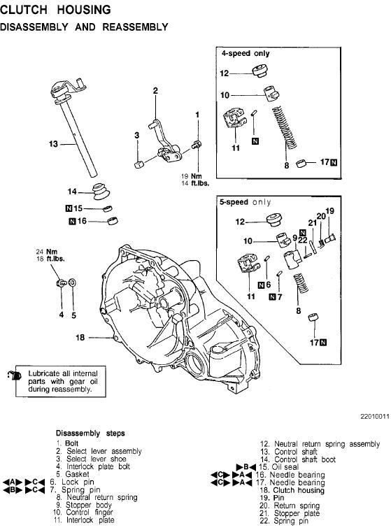

ok, so i searched through the service manual and CAPS. the shifter arm is part of the 'control shaft'. apparently, the arm is some how pressed onto the shaft, and is sold together with the shaft as a unit.
why do you need another shifter arm? it appears that you did the "short shifter mod" to yours by drilling a hole in the arm. even with that hole drilled, you should still be able to use it just fine. are you wanting to drill other holes?

by the way thanks for all the pics. so if your looking down into your engine bay you can see the shift lever, ok so where the shift lever meets the "control shaft" (you can see the top of the shaft on the shift lever) there is some play. my mechanic said this should not move at all and the even though it slightly moves thats what is causing my grinding.
i dont think he is lying cause he told me that he would pay for the part and do the labor for free. its just a matter of getting that part.
so im guessing i need to buy the control shaft and shift lever assembly. ok cool, you answered my question and ill talk to my mechanic and let him know.
