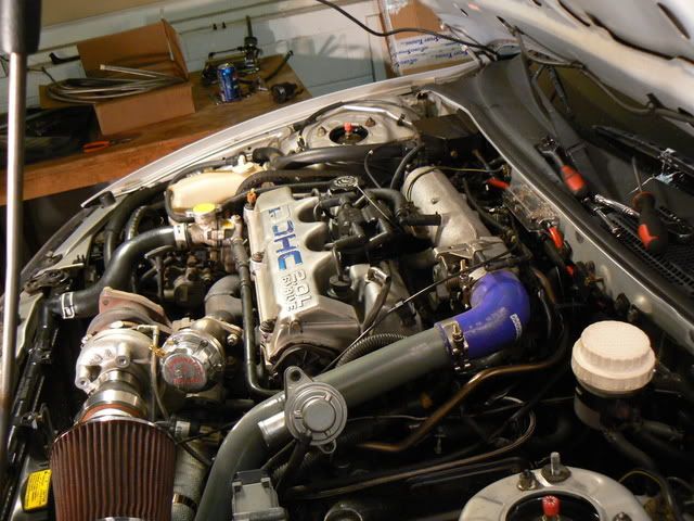

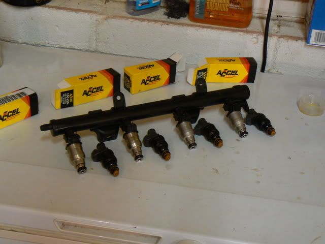

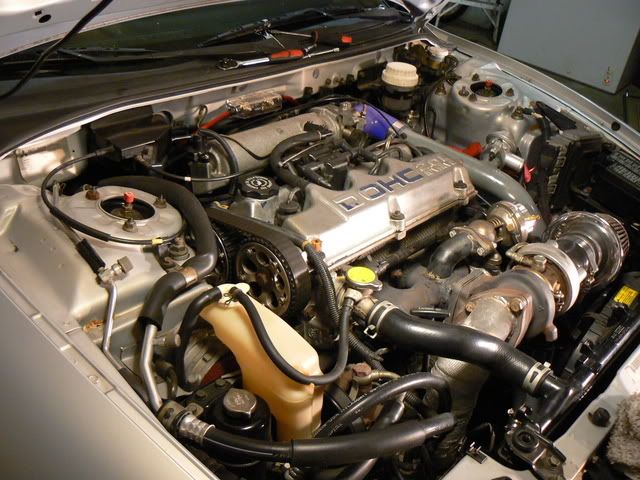

So guys the fuel system in my car started acting up bad and I decided to just redue the whole thing. Go with something that I can tune and now since I have the fuel to support more boost maybe build the motor next summer or something. Heres a list of parts I used.
- Vortech SFMU
- Accel 30lb Injectors
- SS braided 6an return line
- Rewired Fuel Pump
- New Fuel Filter
- New o2 Sensor
- New Wires and Plugs
The car runs alot better now, got it tuned pretty good I think. I'm trying to get everything straightened out with this car since I am going to college in the fall. I can't afford to have something that doesn't run half the time. Anyways heres a few pics, let me know what you think.

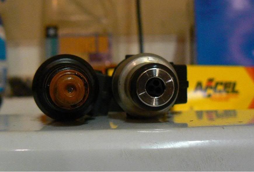

30lbs is around 300 cc right?
SilvrEclipse
06-12-2007, 10:16 PM
310cc. Yes I know they are still small, but anything bigger would require SAFC to control. Considering stock ones are 190cc, they are plenty big. Good for around 13psi.
