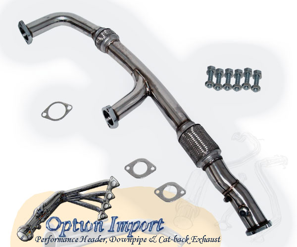

http://images.channeladvisor.com/Sell/SSProfiles/12001151/Images/2/SSDPMGT9199NT.jpg
this is the DP i was looking at, around $130
Stealthee
06-09-2007, 08:37 PM
And if you look its built wrong. The rear bank pipe is flowing AGAINST the flow of the front bank. Not good at all.
well said.. that pipe looks like it will help you loose power

yea good point, could it be turned around?
Stealthee
06-09-2007, 10:23 PM
Not without extensive work.
mr3000
06-09-2007, 10:29 PM
what would need to be done?... cut it off with a plasma cutter and turn it around and re-weld?
Stealthee
06-09-2007, 10:49 PM
If you just did that then its not longer going to be in the right place to mate up with the rear manifold. Youd have to cut it, cut out further back, weld it in and add a piece where the hole is going to be from the now missing piece. SO not worth it.
