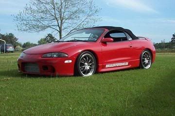

I say the best bang for your buck would be to go with a Eibach spring. If you want to drop it a little go with the Eibach Pro kit but if you want to slam it like mine go with the eibach sportline kit. I've got the same car you do and I have Eibach Sprotline Springs with KYB GR2 shocks. The ride quality in my opinion is awesome. Not bouncy at all and it handles good. With the Sportline springs though you might have some ground clearance problems. The only thing you need to install your spring/shocks is a spring compressor and hand tools and jack/ jack stands. Get an alignment on your car afterwards or else your tires won't last a month.
Heres a pic of my car for reference. (Perfect oppprtunity to show off my car, lol):
http://i12.photobucket.com/albums/a228/nilla_pimp/newmitsusidefrontsmall.jpg
Not to hijack, but are those 18's on it? I like how much it lowered yours... Its like perfect for where I want mine to be...
vanilla gorilla
06-03-2007, 11:45 PM
Yup. 18's and a 40 series tire.
