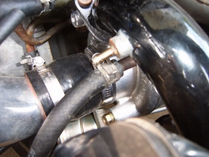

TalonEclipseMixGsx
05-28-2007, 05:07 PM
Yeah man i ran into the same problem. Just go pick up a nipple at the hardware store and jbweld it in. What i did since i still have my t25 is take that nipple off of the compressor housing, the one that u had the mbc hooked too. Drilled a hole in the J-pipe, and threaded it in as much as possible, then JBwelded around it to ensure that it didnt leak. Hope the picture helps.
http://i143.photobucket.com/albums/r149/badeclipse/ughsdasdf.jpg
Black99GST
05-28-2007, 05:54 PM
Thanks! and thats just the OEM one off the stock T-25? because i still have my T25 turbo!
TalonEclipseMixGsx
05-28-2007, 06:06 PM
Yep, took it right off of the old T-25's compressor housing.
