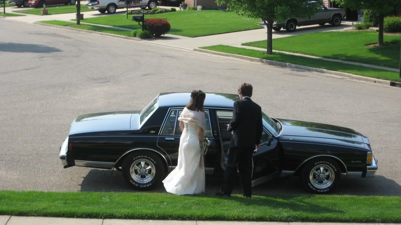

Here's a pic going to Prom last weekend (my son, not me):
http://img.photobucket.com/albums/v94/cone9/IMG_0994.jpg
Cragar S/S 15"x8", Firestone Firehawk Indy 500 - 275/60 rear, 235/60 front

PS a very beautiful looking car - the Cragars look great on it, too.

Yeah i must add to that also, your car looks great! the rims are nice too. but yeah my caprice also spits out black stuff sometimes as well.
