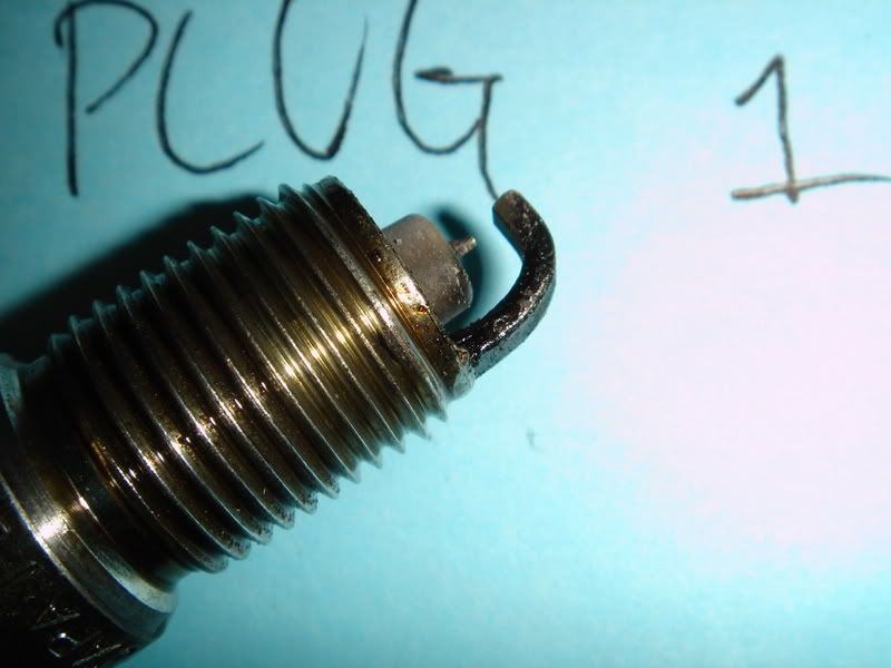

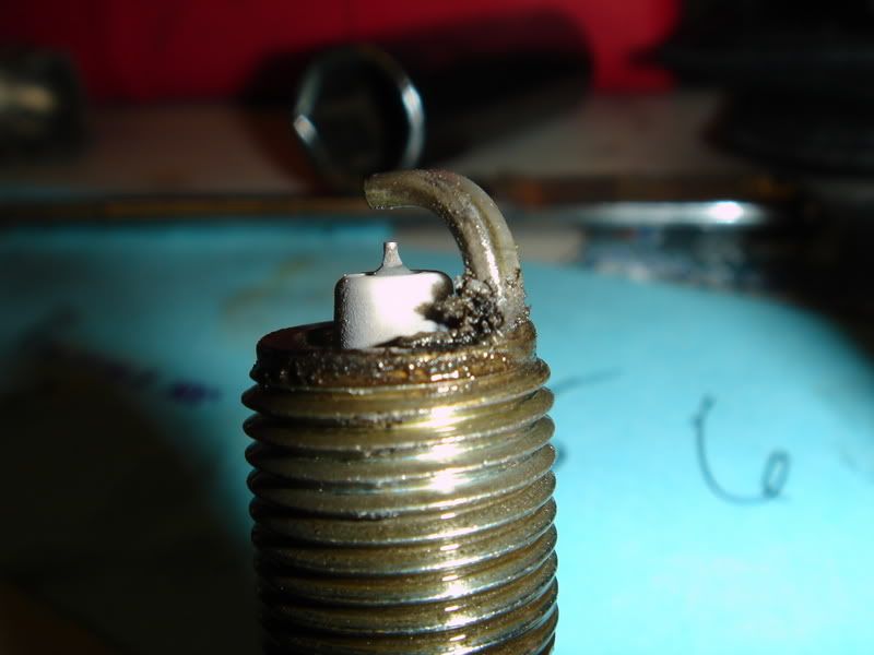

okay.. so i finally got to tearing into some stuff since my car was flashing a CEL..
i figured, misfire since i could feel it hestiate/etc..
i took out 6 plugs, cleaned em.. installed em again (just checking) and i found that they're all covered in oil..AND one of the wires were off (which is what made the CEL flash, prolly)
so i figured ill show you guys the pictures of the plugs and you couljd tell me whats going on w. my broken car.
im going from 1-4 on passenger front to back
5-8 driver, f-b

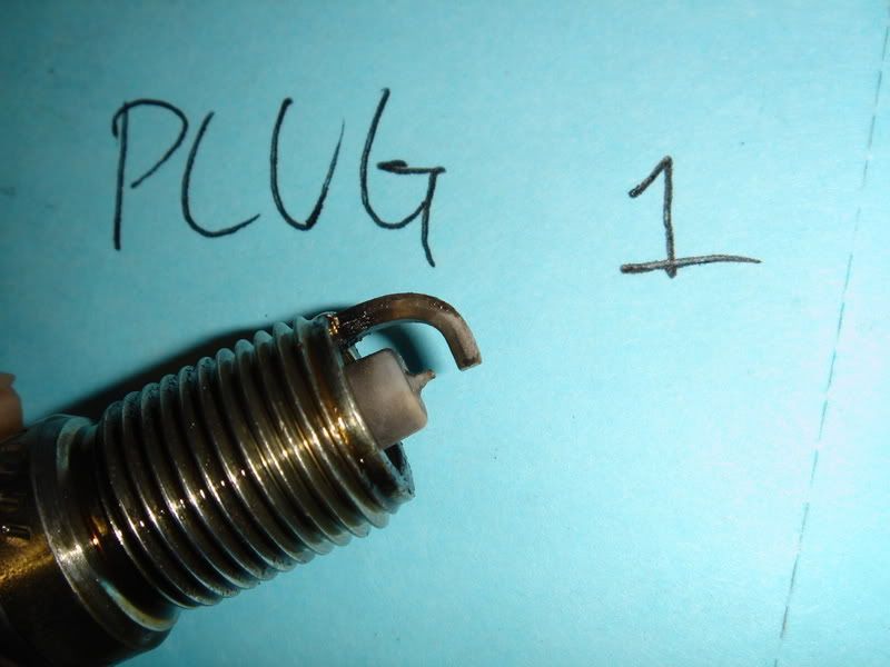

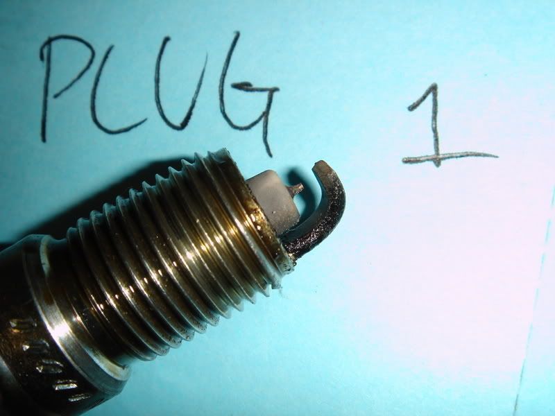

1.
http://img.photobucket.com/albums/v132/ikeyballz/DSC02294.jpg
http://img.photobucket.com/albums/v132/ikeyballz/DSC02295.jpg
http://img.photobucket.com/albums/v132/ikeyballz/DSC02296.jpg

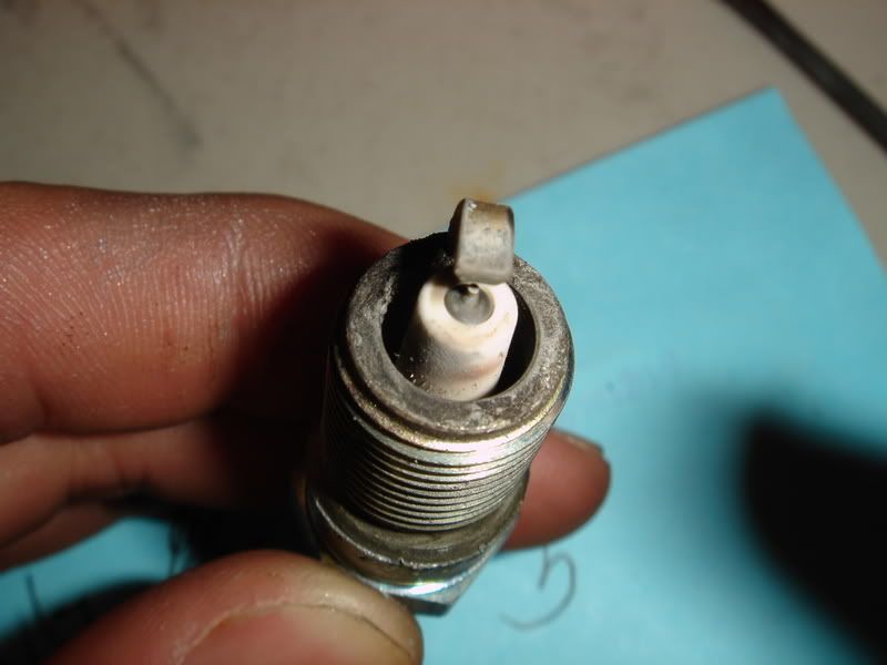

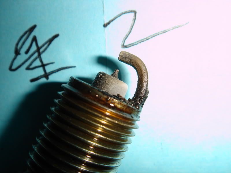

2.
http://img.photobucket.com/albums/v132/ikeyballz/DSC02298.jpg

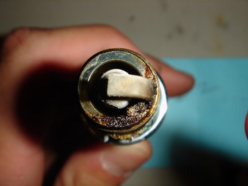

3.
http://img.photobucket.com/albums/v132/ikeyballz/DSC02299.jpg
http://img.photobucket.com/albums/v132/ikeyballz/DSC02303.jpg

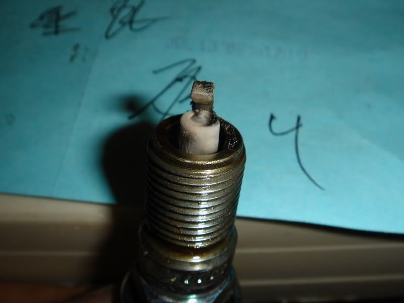

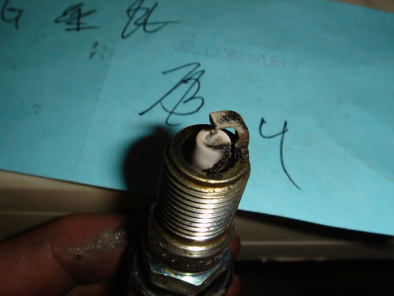

4.
http://img.photobucket.com/albums/v132/ikeyballz/DSC02306.jpg
http://img.photobucket.com/albums/v132/ikeyballz/DSC02304.jpg

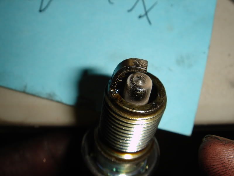

5.
http://img.photobucket.com/albums/v132/ikeyballz/DSC02311.jpg

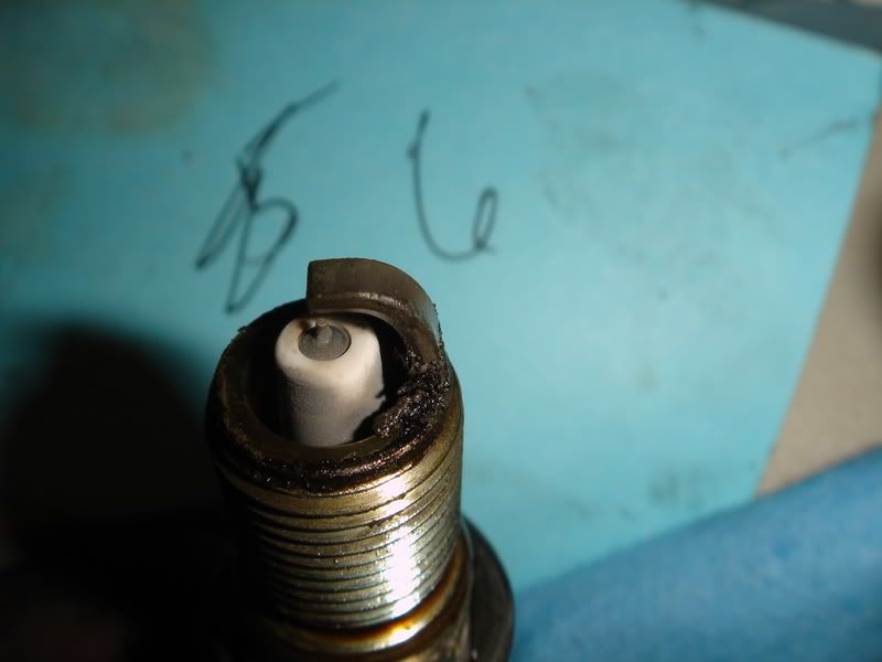

6.http://img.photobucket.com/albums/v132/ikeyballz/DSC02315.jpg
http://img.photobucket.com/albums/v132/ikeyballz/DSC02317.jpg

goldz28
05-14-2007, 10:23 AM
Ouch, is it smoking a lot? With that much oil on them I wold think you have a decent oil leak. Could be getting pass the valves.

wrightz28
05-15-2007, 08:37 AM
One observation here, plug 6 looks to have anti-sieze residue a bit high on the thread, as if too much was used on install.
Second observation is the consistancy of the build up around the tip, kinda like the valve covers leaked or are leaking, and the plug scrpaed up the oil going in (should have burned off), or more likiely coming out. :2cents:
I would pull the new plugs in a few hundred miles as see what's up with them.
ikeyballz
05-15-2007, 04:44 PM
ohh. that weird residue is anti-sieze? damnit. lol
wrightz28
05-16-2007, 08:26 AM
Yeah, when it get's old it looks like watered putty loaded with phlem boogers.
