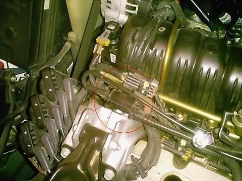

Extended DTC P1441 indicates a problem with the evaporative emissions purge solenoid being stuck open. Located at the engine, right hand side (passenger) in front of the UIM Plenum.
It sounds like it is related to the work done (routing of spark plug wires). Check the electrical connector to the purge solenoid and make sure vacuum line connections are tight and not cracked or broken.
http://i5.photobucket.com/albums/y186/lizzywiz/purge.jpg
Purge Solenoid Location SII 3800

First off thanks a lot for the information. I checked the electrical connector to the purge solenoid and the vacuum line connections. I did put one vacuum line connection back on , but other than that they were tight, no cracked or broken lines. I have driven it for the last few days, but still the same issues SES light on and rough starts when I put gas in it. Any more recommendations?
BNaylor
05-16-2007, 07:36 AM
Which vacuum line was off? Have you reset the PCM module with an odb-ii scan tool since the SES light is on. Or it may take some more drive cycles to clear the SES light since it was an evaporative emissions fault. Also, what brand ignition wires and spark plugs were used?

I took the car into the dealer and had them replace the Purge Solenoid. Now the car works like a charm again. Next I'm going to work on fixing my declining gas mileage. Thanks for your information and assistance.
