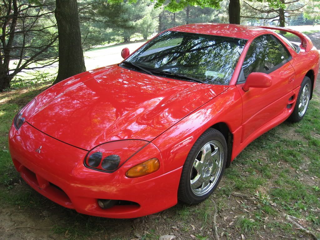

I've got final pics up now. I am very pleased with how evil the front end looks now. Check it out...
http://i89.photobucket.com/albums/k226/X2Xtreme360/exterior001.jpg
http://i89.photobucket.com/albums/k226/X2Xtreme360/exterior003.jpg
http://i89.photobucket.com/albums/k226/X2Xtreme360/delete.jpg
And then here's one taken back in March... The old look
http://i89.photobucket.com/albums/k226/X2Xtreme360/exterior003-1.jpg

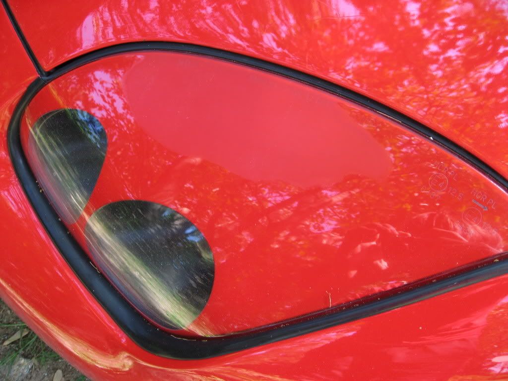

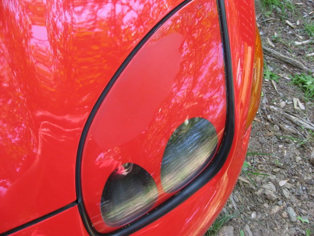

Hi. This is my first post so bear with me. I have a 98' 3000GT SL and I've been looking at that beautiful job you did on your headlights on your 94'. I have a few questions about my driver's side headlight, that it looks to have either a clearcoat mishap when being created, or otherwise the seal was not very good when the "Lexan" piece was sealed onto the main body of the headlight assembly. I was wondering first off, what this could have possibly been to create this "bubble of air" or whatever it was to discolor my headlight, as well as to how hard it would be and what would need to be done to get roughly the look of X2Xtreme360's headlights. I wanted to do something like this before I even bought the car, so I was just wondering how you'd have approach this for a 98' GT. Thanks for any help in this process. Here's some pictures of the problem I was talking about as well as a pic of my GT. Hope someone can help. :)
http://i183.photobucket.com/albums/x216/Atomicornpuffs/IMG_0521.jpg
http://i183.photobucket.com/albums/x216/Atomicornpuffs/IMG_0519.jpg

05-15-2007, 05:04 PM
thats weird. is it rough to the touch? looks like it was sanded or something.
anyways, yea, like stealthee said, try and get your hands on some 94 headlights.

I don't believe it's been sanded. I went out there today to go look at it really close and was just wondering about it. So apparent if I don't have the 94' headlights, it's not created with the glass seal as opposed to the 95' and newer which have the "Lexan Plastic" I presume. And from what I know of the 95' and newer, the paint is right on the inner part of the plastic seal, unless I'm mistaken. If so, could it have been that the layer of paint was not put on right for it's first coat? As well as my other question is, not more of whether or not it'd be easier to do the headlight mod if I had the 94' lights, but my question is, is it possible to do it with a 98' 3000GT's lights, and if so, does anyone know the steps to doing this. Thank you to anyone who can give me advice on this question of mine.

Thats a common happening on all the lexan headlights. Its a clearcoat on the outside.
http://jagvr4.8m.com/hrestore.htm
Follow that link to clean that up. As for the robo mod, its not going to be anywhere near easy with the lexans. As stated the paint is directly on the inside of the lexan. If you remove the lexan cover you will see where its painted. It would tons and tons and tons of work to get it perfect to be able to pull off the robo mod. Get ahold of some 94 lights.... Like BUY MINE. :D

thanks for the link stealthee for getting the apparently clearcoat problem addressed. That link though I have a question about if anyone knows. The guy is saying to wet sand using 1000 grit sandpaper and continuing up to 2000 grit sandpaper, by any chance could you use a product like Nu Finish Scratch Remover to take car of this problem of stripping away the clear coat? I'm just wondering because with sandpaper this fine, it I would think would act just the same way as the microscopic ways of Nu Finish, so just if anyone has any input on that. also, does anyone have any experience with using Nu Finish car polish? is it actually as good as people say? thanks.

no, its a flaking of the clear problem. You could however use some new finish as an additional step to teh resotoration.

wait, a flaking of the clearcoat? so the nu finish stratch remover/clear coat remover wouldn't work for what I have? I'm just questionable of what a flaking actually means. because are the pictures that I posted on here looking like flaking? I'm unsure, as to what just the flaking is. and after I'm done this process, seems only natural that I'd want to polish up the rest of the car to make it all nice and spiffy again. :)

Yes that is most definitely clear coat flake on the headlight. The only way to fix it is to wetsand and polish it as per the link I posted.
