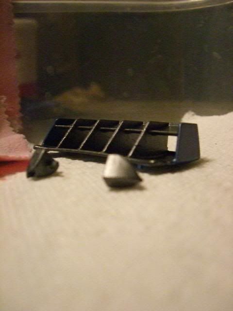

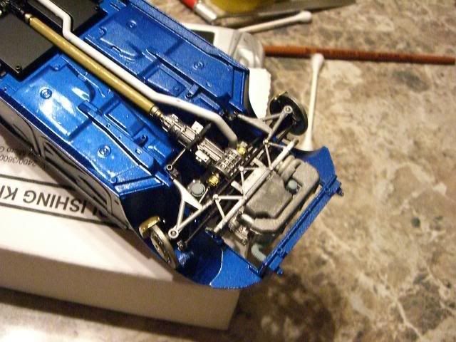

I have som pretty crappy pictures of progress so ill give you two..
I know this is not the right section but why start a thread for two pictures..http://i80.photobucket.com/albums/j199/dasweetie88/spoiler.jpg
http://i80.photobucket.com/albums/j199/dasweetie88/bottom.jpg
klutz_100
05-15-2007, 01:54 AM
Start a thread.
This isn't the right place for progress shots unless they are directly related to the issue - in this case clear paints.
