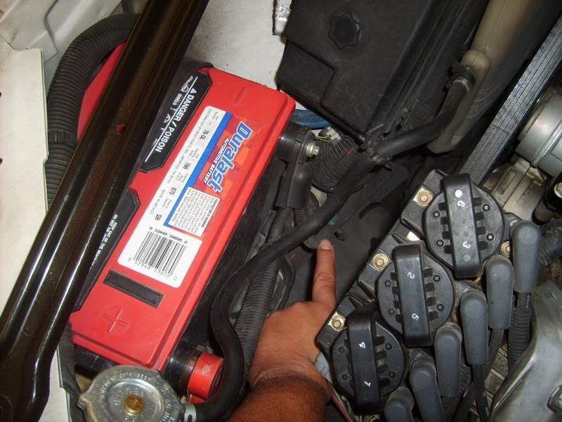

BNaylor
05-19-2007, 04:12 PM
it is a black cable but it's tied into the positive battery cable on my car.
And what GM car - year and model is this? :screwy:
Here is a pic from a '99 Regal LS which has the cable going to the ground stud at the right fender apron. The positive feed only goes to the PCM module, starter and engine compartment fuse box. My finger is pointing to the cable that terminates at the ground stud on the fender. As you can see it is connected to the negative side. The main part of the ground terminates at the engine/transaxle grounding stud.
