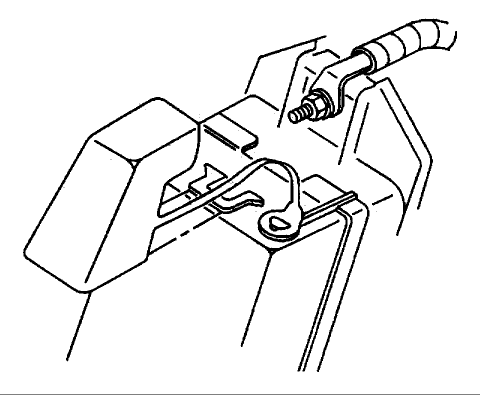

this seems like a loose fuse box connection. Check the connection and make sure the fuse-box is tight.
http://i41.photobucket.com/albums/e277/liquid100percent/85088982.gif
Was your alternator replaced with the new part number =the upgraded alternator has a new part number.

the alternator check won't work. The alternator field collapses due to vibration while the car is moving. Put a cheap voltmeter across the battery while the car is moving = when the alternator field collapses you will go to battery voltage (12.6V) or less from ~14V+ (charging voltage)
clean off all battery connections and use a dialectric grease (conductive grease).
