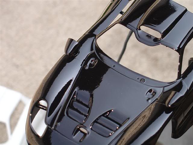

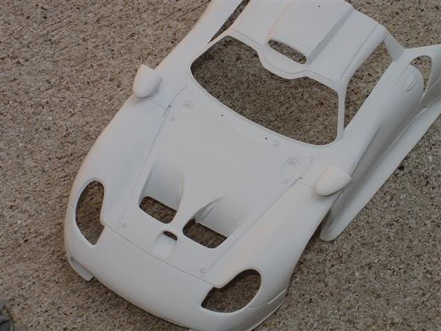

Here is a picture with body primed.
http://i203.photobucket.com/albums/aa73/wallacesells/DSC02266Small.jpg
Here is a picture of the hood pins after painting.
http://i203.photobucket.com/albums/aa73/wallacesells/DSC02267Small.jpg
They are just blobs of paint with no definition to them. I think my wet coat was sprayed too closely to the body. For the wet coat, should you be the same distance from the body and just sweep by more slowly? Is the distance from the can to the body the same for mist and wet coats?

Too thick, and waaaaay too fast. Relax man, it's not a race. There are no points for getting into the stripping tank first. :grinno:
First off, it looks like you're having trouble with 'wet' coats. Everyone has their own favorite methods, but I never apply a heavy wet coat. Everything I spray gets built up in light or medium mist coats. Wet coats may give you the instant satisfaction of having it come out shiney NOW, but if you fill in details you've ruined the paintjob. They can be extremely difficult to control, and really aren't necessary. Do it all in steady, even mists. And give it 30-60 minutes in between mist coats.
Second, never apply primer, paint or clearcoat in the same day. Just don't do it. Wait at least overnight between everything. Always. The primer/paint need time to outgas before being covered, and you need time to relax, clear your head, check and correct any imperfections, and think about the next step. A good three step paint job should never take less than three days, at an absolute minimum.
Third, if you're clearcoating, why not leave it until after the decalling is done? They will look better and be protected. Just make sure that when you do that you apply the clearcoat in very light, slow mistcoats. Leave 1 to 2 hours in between mistcoats of clear to let the clearcoat outgas. If you don't, you're inviting the solvants to eat the paint and decals beneith them.
It cannot be done well fast. If you want it to come out, you're going to have to be willing to put some time into it....
For stripping, get yourself some 91 or 99%, and a coverable container to dunk the body in. It's a safer option than oven cleaner.

Absolutely agree with MPWR - too much, too fast. How doest it go?... More haste, less speeed....
The only thing that I would add to what MPWR said is that, if you are goinfg to use spray cans instead of your airbrush, stand the can in a bowl of warm (NOT boiling) water before spraying . This will warm the paint and increase it's flowing properties.
Every time I do mist coats, it seems to be a rough texture. It's not until the wet coat that I get a decent shine. Unfortunately, this is also about the time that panel lines get filled in as well as hood pins, door handles and the like. If you do all mist coats, how does it ever get a shine?
Can someone do a video from start to finish of how to paint and put it on youtube? I'll host a frickin' party if someone lives nearby and can demonstrate!:grinno:
According to the can, you should wait 10 minutes between coats and all coats (inlcuding clear) have to be applied within 1 hour. This is an acrylic enamel not an acrylic lacquer. I'm not trying to be difficult; I'm just wondering why you do it this way when the manufacturer recommends a different way. Then again, I seem to be the one stripping bodies 3-4 times....
I've done that in the past, but the consensus seems to be that it looks more realistic to apply decals over the clear. I'm also working on the 2000 D2 DTM car at the same time and would hate to screw those decals up. The Tamiya decals polish up nice. I'll try it this time as these decals are cheaply made.
I'm an expert at stripping. Paint that is. It works great, except it won't take primer off.

Have you ever seen the movie "Days of Thunder" with Tom Cruise? There's a great scene in there at the begining.
Robert Duvall is trying to coach Cruise about tire useage but Cruise is being obstinate. In the end they reach a deal - Cruise will do 15 laps his way, change tires and then do 15 laps following Duvall's advice.
When they compared results, it turned out that Duvall's way was actually faster around the lap and the tires were still good for another 100 laps.
You have already followed the advice on the spray can and you have seen what you get. Now try MPWRs way and see what you get. ;)
BTW mist/light coats DON'T shine. You put the shine on at the very end of the process.
During the paint application process, your primary objective is to gradually build up a sufficiently thick (and no more) smooth layer of paint that is free of grit, shit and orange peel. Painting i slike baking a cake - it's easy to add a tad more flour to the mix but if you put too much in, you cant take it out.
You can (should if necessary) wet sand away any imperfections after EVERY coat including mist coats if necessary.
It is virtually impossible to over thin paint. Better too thin than too thick. Thinner paint just means that you will have to apply more thin coats.
Honestly, your major problem seems to be haste and a heavy hand. If you search the forum you will find the same advice everywhere so there must be something to it ;)
