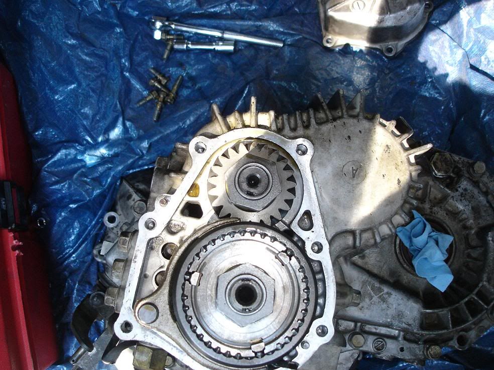

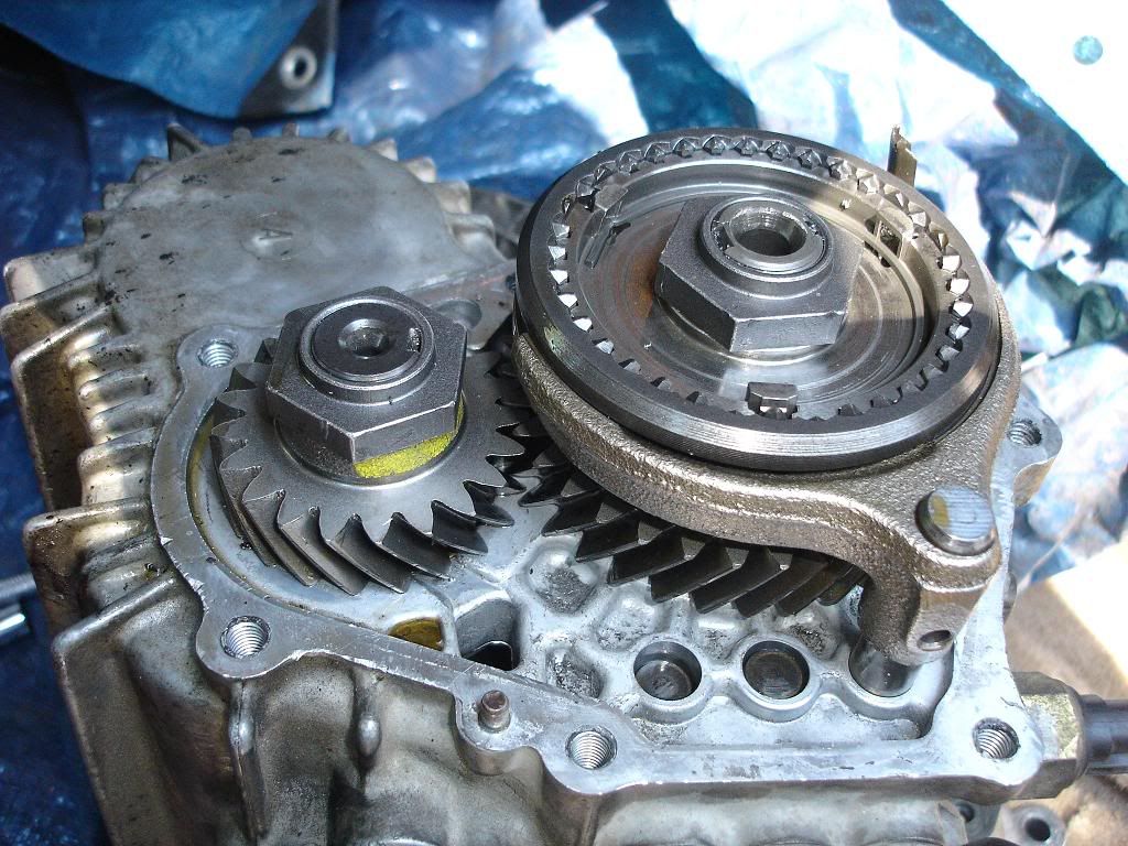

you can check the shifter linkage to make sure its secure (beneath the air filter box, on top of trans), but i highly doubt that is the source of your problem. this is a common problem on high mileage FWD manual trannies for our cars. often, something in the 5th gear assembly has come loose and/or a part or two is missing or damaged.
if you check the linkage and everything look secure, i would then suggest you remove the end cover on the trans. this is easily done with the trans still in the car, and removing this cover will reveal the 5th/reverse gear assemblies. visual inspection should be enough to determine which parts are out of whack.
to access the tranny end cover, jack up the passenger front tire, remove tire, remove inner fender well plastic revealing the transmission. the end cover of the transmission (right in front of you) is held on by 7 bolts. remove the end cover and snap some pics, upload them here, and i can tell you what's out of whack.
here is the end cover
http://bmtranny.escic.com/images/000_0370.JPG
5th/reverse gears
http://i57.photobucket.com/albums/g236/Linebckr49/3000GT/DSC02437.jpg
http://i57.photobucket.com/albums/g236/Linebckr49/3000GT/DSC02438.jpg
5th/reverse gears
