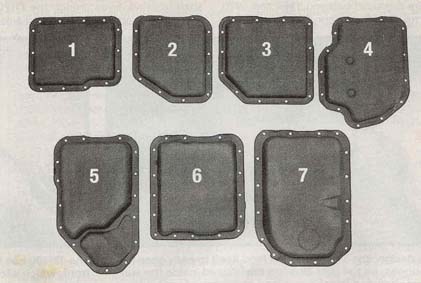

just for shits and giggles, if anybody has pictures of how to identify the trans by the pan, it might be fun to make sure that i really do have a TH350 and not the 700r4, and that my adjusting the kickdown cable about 2000 miles ago wasnt actually the TV cable, which could be bad.

http://www.silicon212.org/pan_id.jpg
Pan 1 is an aluminum Powerglide (for reference only)
Pan 2 is a TH200/C
Pan 3 is a TH250/350/375B
Pan 4 is a TH400/3L80/TH375
Pan 5 is a TH2004R
Pan 6 is a TH700R4/4L60/E
Pan 7 is a 4L80E
If you have one of either 5 or 6 (OD) your shift quadrant will be
P R N (D) D 2 1
-or-
P R N D 3 2 1
If you have 2 or 3 your quadrant will be marked
P R N D 2 1
