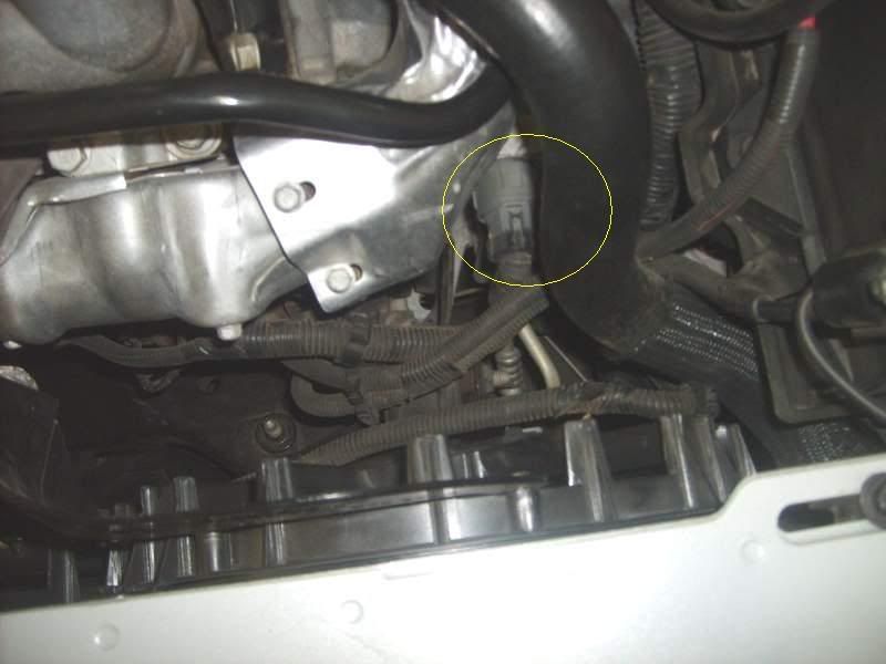

Alero(00)
05-04-2007, 07:02 PM
I have the same trac off light on my alero 2000 2.4 L ( 189000km). But my tranny does not appear shifting hard ,
Bynalor mentions a easy way to check it out by unpluggging the big gray colored connector and reconnect it again. Where is the exact location of this connector and what does it look like ( inside the engine compartment ? )
I appreciate some help.
In the past, whenever I press the ETS button, the "Trac off " warning light will be responsive to the switch. but now the warning light can't be turned off by pressing the ETS anymore. Wonder why?

Since the OP had tranny related faults I mentioned the connector plug to the tranny. See pic below. Item circled in yellow. In your case I would suspect the ETS switch at the console, wiring harness into the dash and to the EBTCM module or the EBTCM module.
http://i5.photobucket.com/albums/y186/lizzywiz/alero_plug.jpg
4T40/4T45E Autotransaxle Electrical Connector Plug Location - Front left (driver's side) looking in to engine - Example shown 3400 V6

Alero(00)
05-07-2007, 12:02 PM
Thanks for the detailed pic from bynalor.
I was considering to have the car scanned for diagnostic trouble codes in a car dealer.
But , strangely the "trac off " warning light disappeared today without any unusal occurance.
Now the car seems working well, with the "trac off "light des not stay on when I turn on the engine . I only hope the warning light won't come back on again.
