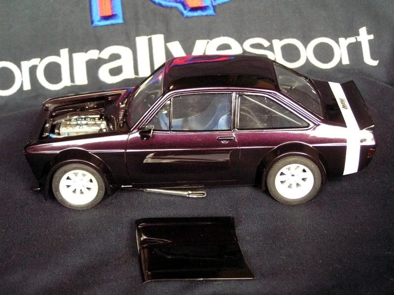

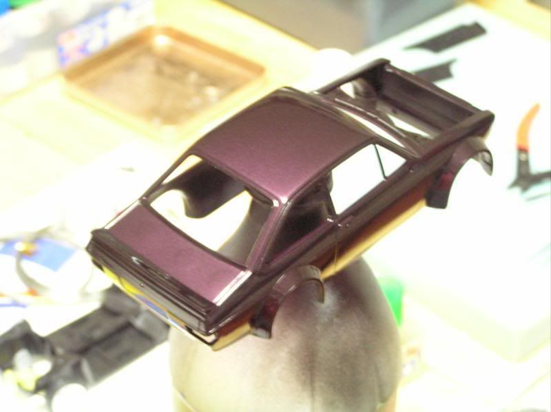

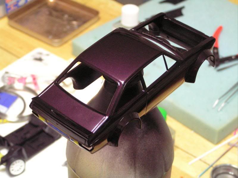

The flakes look a little big. Are they so obvious in the flesh?
Here's a couple of pics of Zero's Nissan Midnight Purple pearl:
http://i35.photobucket.com/albums/d177/MattRS2000/Models/Zakspeed%20Escort/TN_PB170085.jpg
http://i35.photobucket.com/albums/d177/MattRS2000/Models/Zakspeed%20Escort/TN_PB170086.jpg
http://i35.photobucket.com/albums/d177/MattRS2000/Models/Zakspeed%20Escort/TN_P1310033.jpg
