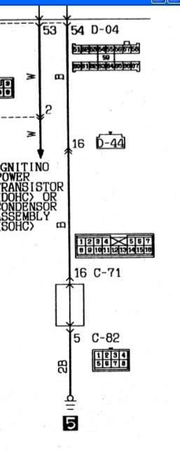

ok so ever since i had my vr4, my tach has never worked. I have tried someone eles cluster, but there tach did not work on my car. Ive checked the voltage coming out of the ptu (Tacho) and i got good voltage. Ive also checked for loose harness behind the cluster and they were ok. When i turn the key, the needle only moves about 1/16 of an inch and it stays there untill the key is in off. I got this schematic from a guy on 3si, But i dont know where those connectors are. here is the cut from that schematic. http://img.photobucket.com/albums/v478/dadandmom/DELETETACH.jpg

D-04 is embedded in the dash behind your speedometer gauge cluster. If you pull your gauge cluster out there are 3 connectors mounted behind that the gauge cluster plugs into. From the looks of my configuration diagram, its probably the top left if your looking at it from the driver's seat, but check the number of pins on your little schematic sheet with your actual connectors to be sure first.
D-44 is under the dash to the far driver's side of the car. That one doesn't look like its very much fun to try and access.
C-71 and C-82 are connected to the fuse box under the dash and the driver's side. C-71 should be on the front side of the fuse box, on the far right, second from the bottom. C-82 should be on the rear side, on the far left (if facing the rear of the fuse box) in the middle.
Hope this helps.

That is the information I did need. Thank you very much. I just wanted to know where did you get those locations? All data?

I got them from my service manual.
