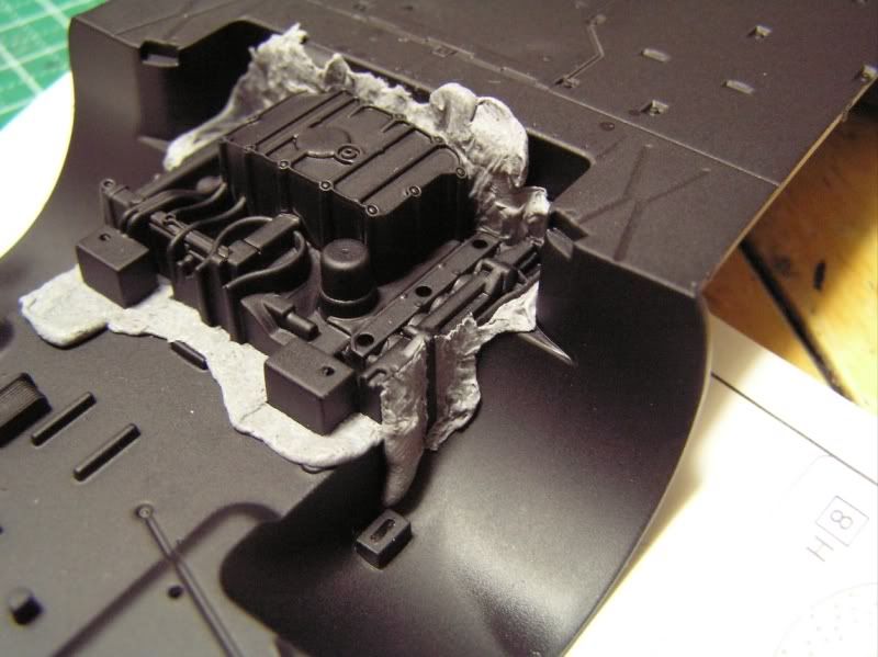

For chassis masking, you can't beat good old Blu-Tac! (I don't know what it's called in other countries, it's the sticky stuff used for putting up posters.) Here is a picture of my Cayman with some Blu-Tac masking the engine:
http://i35.photobucket.com/albums/d177/MattRS2000/Models/Porsche%20Cayman/TN_P1030062.jpg
I wouldn't use anything else, it's so easy.
