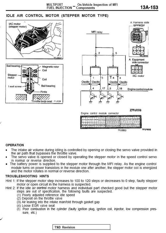

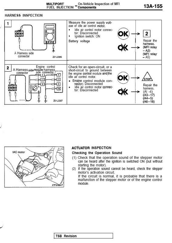

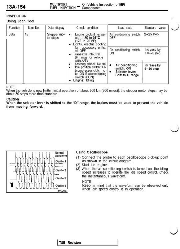

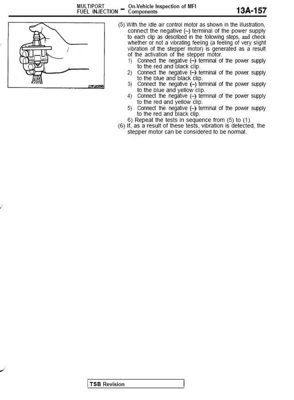

these cars have several ways to adjust the idle, and a few things that control idle as well.
there is an ISC/IAC motor (idle stepper control/idle air control--same thing just different names for it) on the bottom of throttle body that allows air to bypass the throttle body under certain conditions to maintain a good idle (like when the A/C is turned on, or cruise control is on, etc.). this motor wears out over time b/c these cars are 10+ years old. here is a link useful in diagnosing the ISC: www.dsmisc.com.
here is some more useful info on the ISC:
http://i57.photobucket.com/albums/g236/Linebckr49/3000GT/IAC/IACpage1.jpg
http://i57.photobucket.com/albums/g236/Linebckr49/3000GT/IAC/IACpage2.jpg
http://i57.photobucket.com/albums/g236/Linebckr49/3000GT/IAC/IACpage3.jpg
http://i57.photobucket.com/albums/g236/Linebckr49/3000GT/IAC/IACpage4.jpg
http://i57.photobucket.com/albums/g236/Linebckr49/3000GT/IAC/IACpage5.jpg
