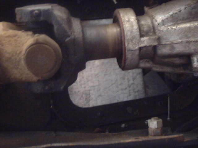

The swap is a simple. Everything should line up pretty much. you need the 350 filler tube and the torque converter. Other thing you will need is a free manifold vac and a long metal line to run to the very back of the transmission. The difference in length is about 1/2 inch. Mine has a 700r4 driveshaft that goes 350 after the front u-joint. No probs. Here is where it ends up.
http://i2.photobucket.com/albums/y18/hotrod_chevyz/1982%20Pontiac%20Trans%20AM/sheetmetalshifterholecover.jpg
It started out as a 4 speed std, then converted it to a th350/v8, and im building up a low mile pontiac 400/400 for it next. If it ever has a SBC again it will be with a 700r4. That way i can gear the axle to something worth having.
