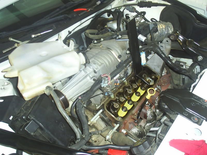

Installed 1.9 Roller Rockers today:

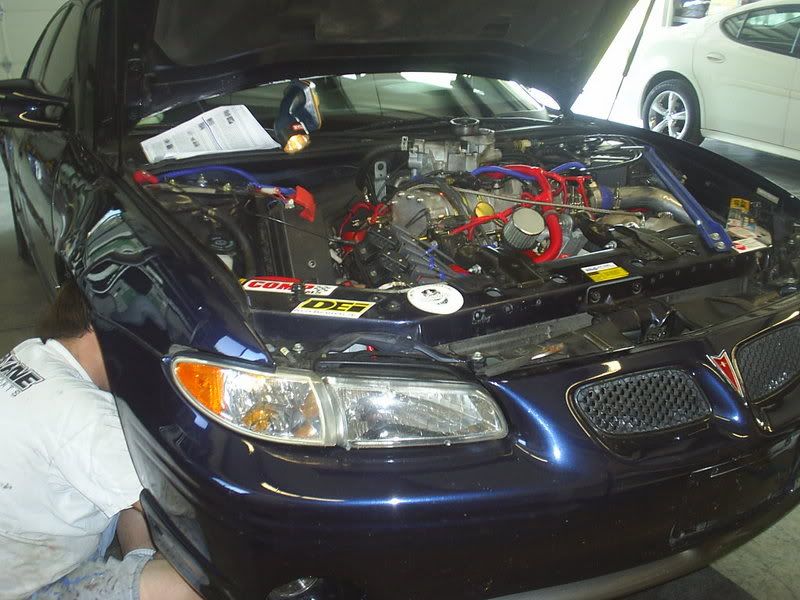

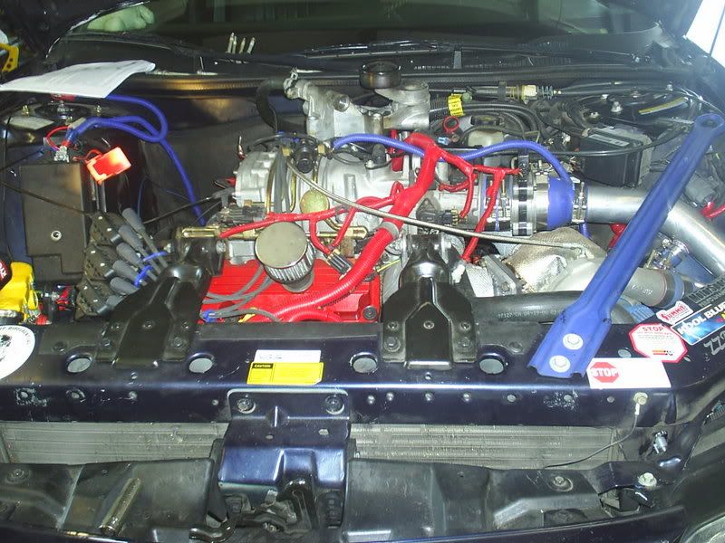

Doug's turbo GTP:

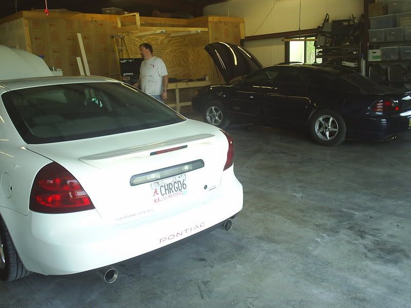

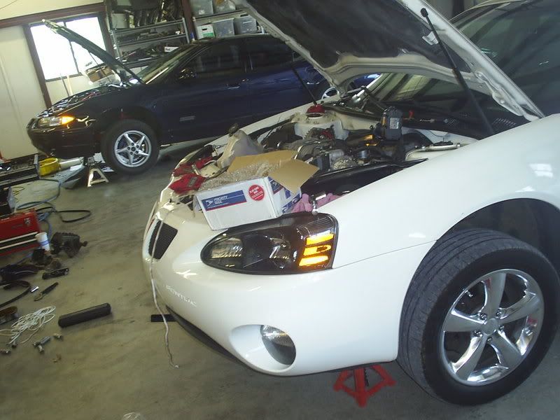

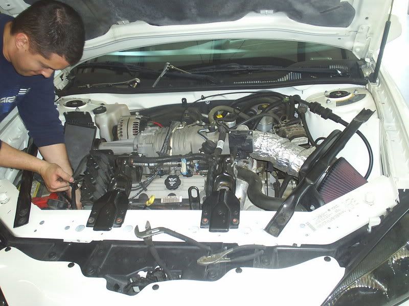

since the fuel trims are still being learned by the PCM, I haven't been able to fully test the new setup, but I will say in the few blips of the throttle and the one 25-75 run, the car is definitely a stronger runner, the install went pretty smooth with a few snags a long the way(misplaces a valve lock, had to hunt it down, had a spark plug start to free spin so I had to remove it, and had a bad misfire on the initial startup on cylinder #4, replaced the plug with another one, checked the plug wire on the coil and tried again, and it started up fine)...
i'll be glad to put some more miles on it so I can try it out...

about 12 hours, but we took our time being very careful and took several breaks, none stop, it could have been done in 4 hours or so... we made a day out of it, rushing a job leads to problems...

just getting all of the stuff out of the way to get to the valve covers was time consuming, we put a jack under the car on the transmission with the dog bones loose and rolled the engine forward, honestly, in removing the old parts and putting the springs, retainers, and rockers in, there probably wasn't but an hour and a half of actual work... the hardest part its getting stuff out of the way so you can work, and then all of the setbacks we had(though none were "major")... We also did the back 1st, that way once we got those 6 done, it was a cake walk home, the smart way to do it...
