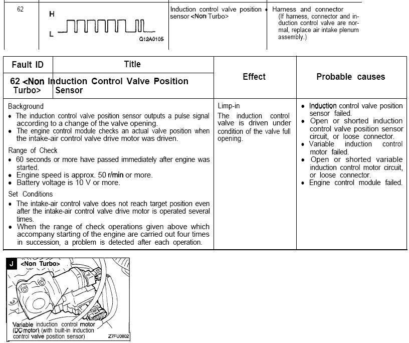

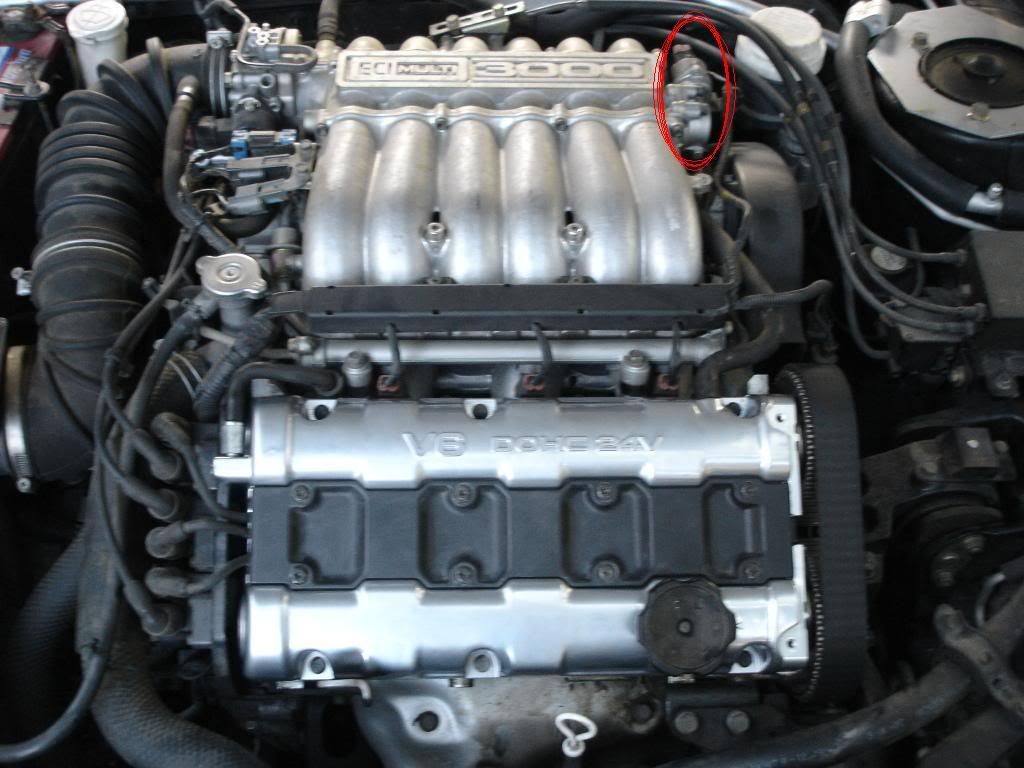

you must have an NA. i'm pretty sure you are talking about the VICS motor (variable induction controller). its held on by 3 or 4 allen head bolts. you can either remove the bolts, taking out the entire motor, OR you can just unplug the 2 connection on the motor. if you decide to remove it, the gear inside will rotate (you'll here a snap as it rotates 90 degrees). pay attention to which way it rotates, as you'll need to rotate it back the same way when you reinstall it. b/c i've seen people mess it up and forget to rotate it back, i would just unplug the 2 connectors from the motor.
