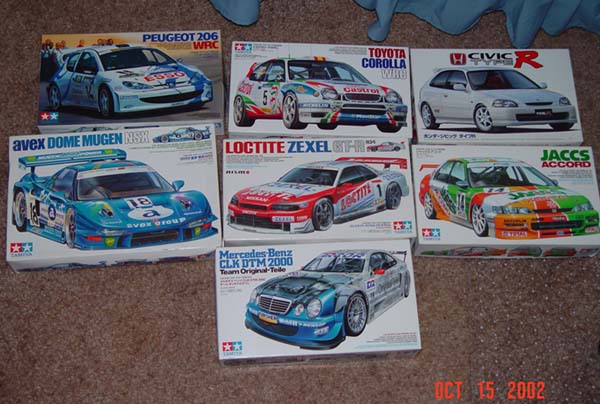

Oh and yes i do have a digital camera. Heres some pics of my kits and others.
My cars:
http://files.automotiveforums.com/uploads/675551cars1.jpg
