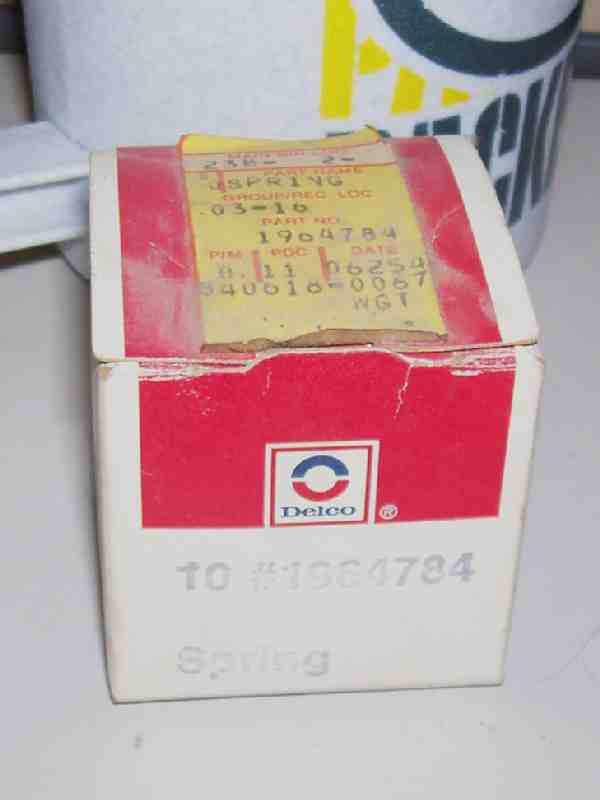

Check your canceling springs. They used to fail so frequently, GM used to offer boxes of ten of them for about three dollars. I think I still have half a box around here somewhere.
Yup:
http://www.wwdsltd.com/files/TurnSignalSpring.jpg
When you reassemble, clean all the moving parts and apply a fresh layer of white lithium grease.
