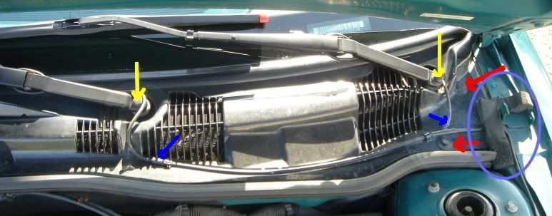

- First open the hood.
- Then pop off the caps over the wiper arm nuts, indicated by the yello arrows.
http://i28.photobucket.com/albums/c242/xeroinfinity/Cold%20Air%20Intake/Wpercowelremov.jpg
http://i28.photobucket.com/albums/c242/xeroinfinity/Cold%20Air%20Intake/Wpercowelremov2.jpg
- Next disconnect the washer fluid lines, shown with blu arrows.
- Then remove the wiper arm nuts 13mm , lift wiper off the glass to releave the pressure on the shaft, lift arm.
* You may need to pry under the wiper arm by the shaft to remove the wiper arm(s) and placing something under the pry tool to protect the cowl is recomended.

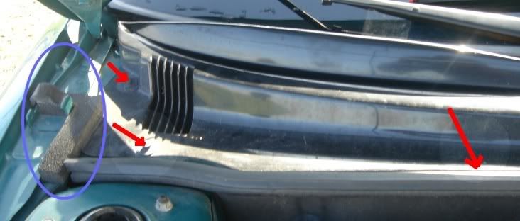

- Remove the push pins holding the cowl bezel down indicated by red arrows.
- I would be carefull with the foam in place on this bezel its probly glued and will need reused or replaced.
- Shown in the blu circles, this keeps water out of the cabin area.
- Next remove the cowl cover, should look like this.

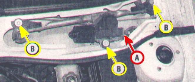

http://i28.photobucket.com/albums/c242/xeroinfinity/Cold%20Air%20Intake/wiperassyremoval.jpg
- Disconnect the wire plug connector listed as "A" in Red.
- Remove Motor & linkage assy bolts, "B" in yello,
then pull out the motor & assy.

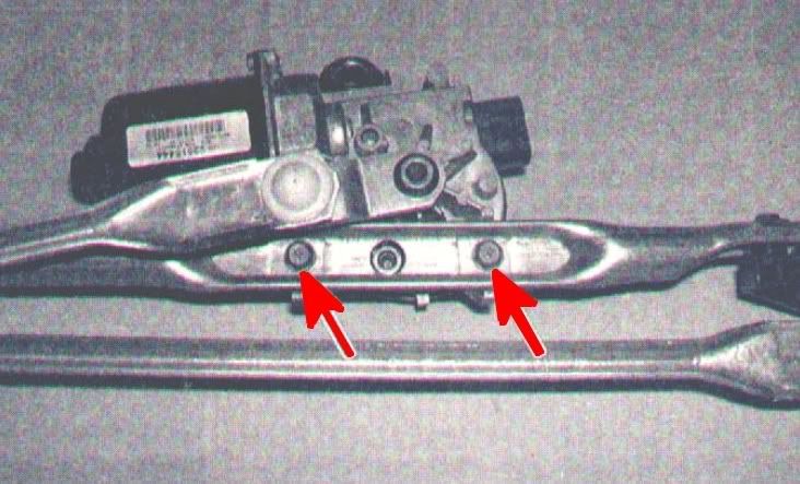

- Here is a picture of the motor and linkage assy removed.
http://i28.photobucket.com/albums/c242/xeroinfinity/Cold%20Air%20Intake/wipermotorlinkage.jpg
(Thier are two parts, the motor and the linkage/transmission)
- Install in reverse procedure.
