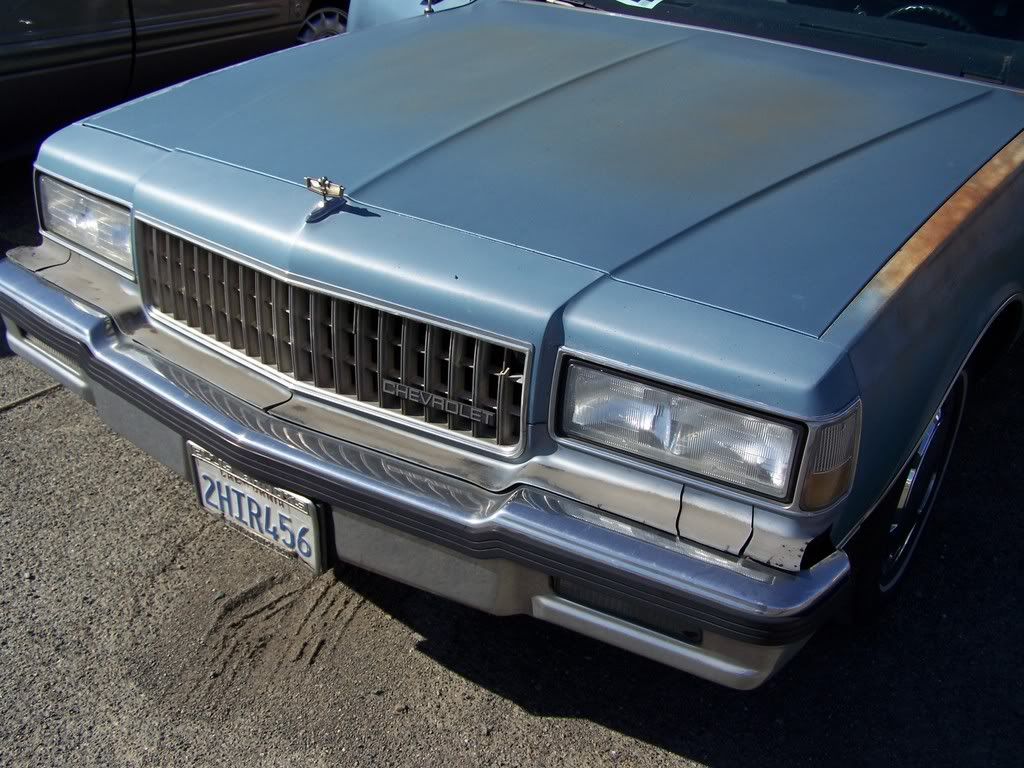

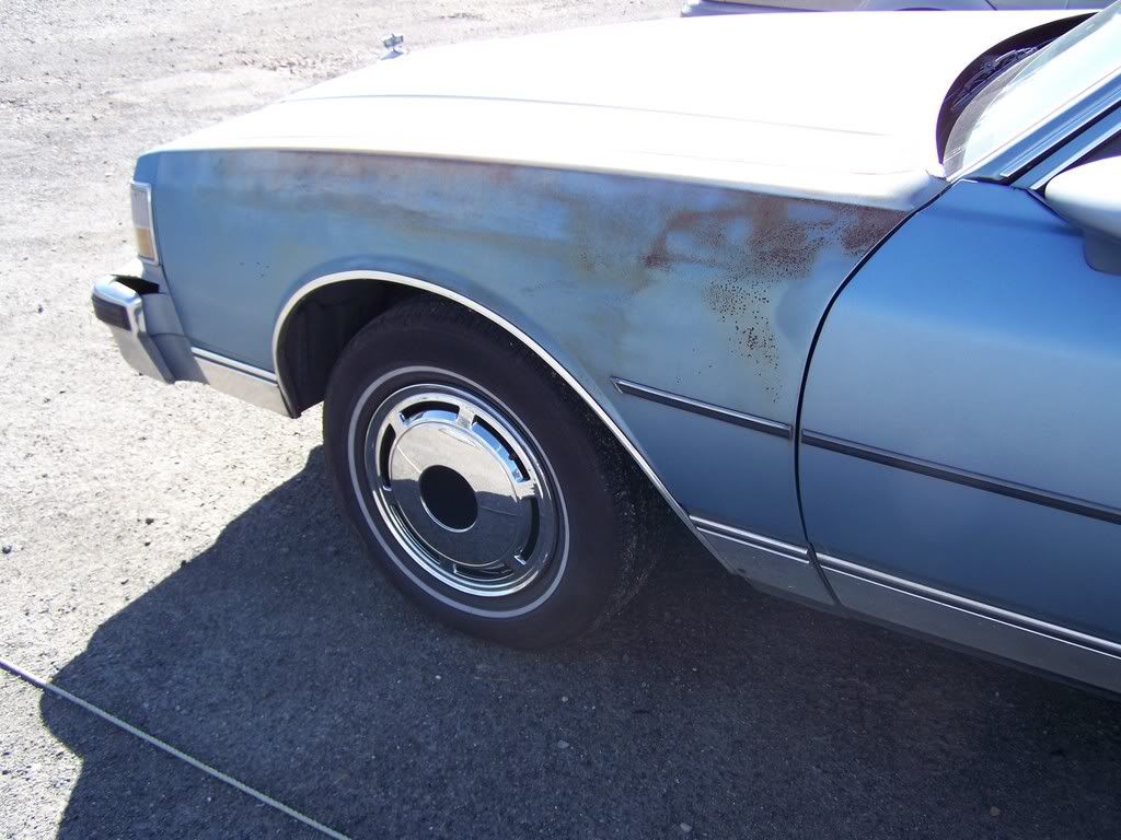

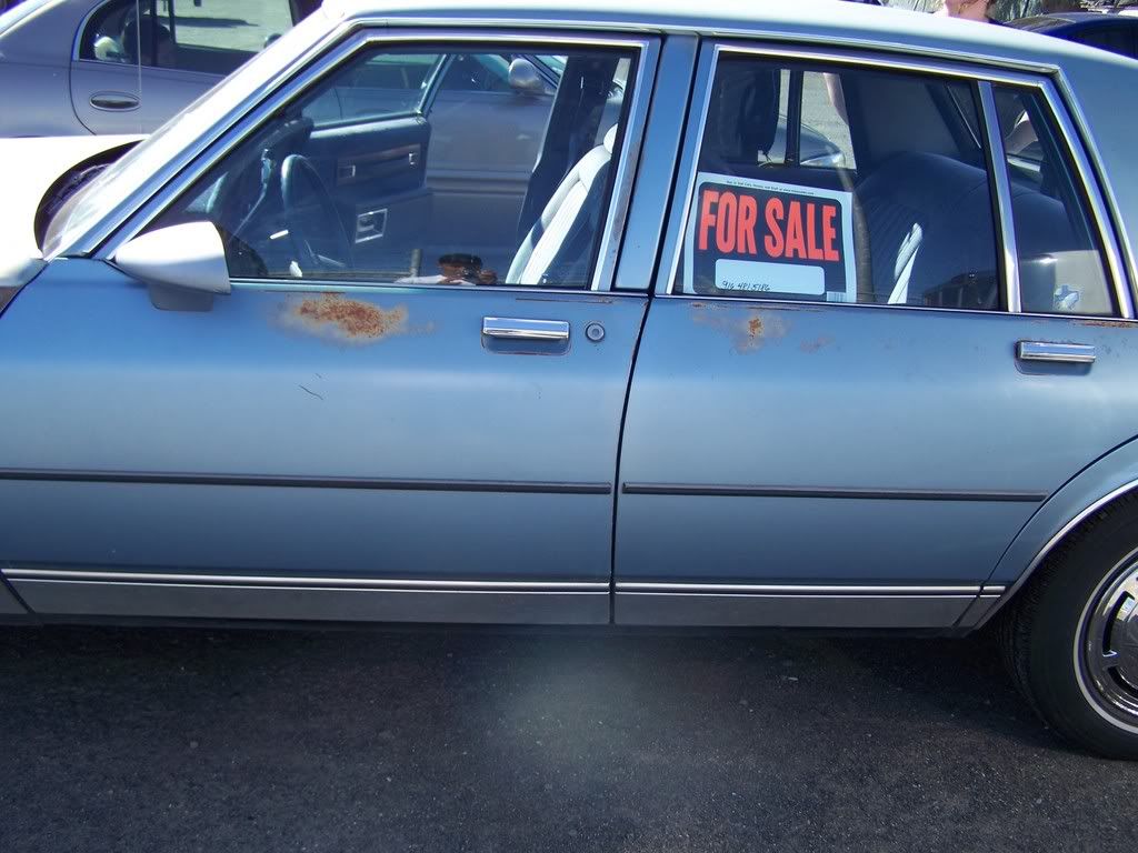

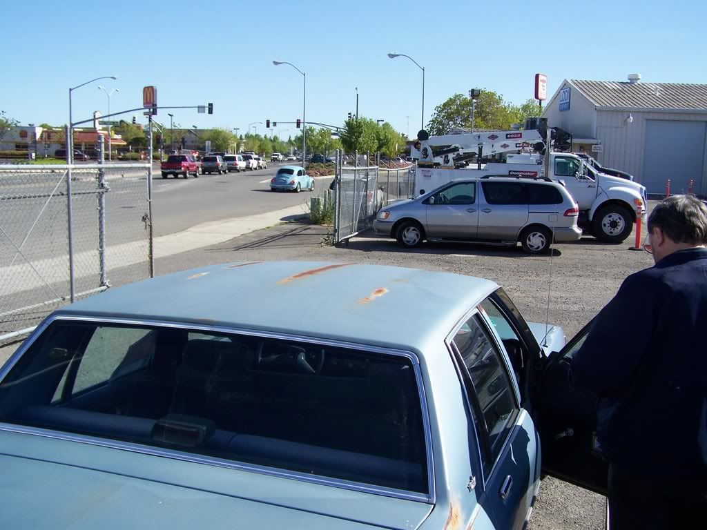

I'm no expert on rust, so I figure you guys could help me out.
This is an 88 caprice, I been looking for this specific year for so long and finally fount one, car runs great. Interior is pretty clean too. BUT there are some rust spots on the car. Now I'm no expert on rust but it didnt look too bad. There arent any spots where it has eatn complelty through. Looks like just on the surface.

Now how should I go about this problem if I go and buy the car this Monday? If I take to a body shop and and have it primered and get it taking care of will the rust be gone forever lol?? I did some googleing and was reading somthing that said you cant get rid of rust once it has started.

It is true that rust will not stay gone if not taken care of properly. If thoroughly sandblasted, and properly primered and painted there is a very good chance that the rust will not resurface as long as you keep it out of the salt, and keep the paint well waxed.

This is surface rust, no big deal. It is not of the 'cancer' variety by its appearance.
Check the underside of the car for rust.
As for the car in the pic, sand all of the paint off or have it media blasted, use an etching primer on the bare metal (this is expensive, but necessary if you don't want this to happen again), and paint the car.
