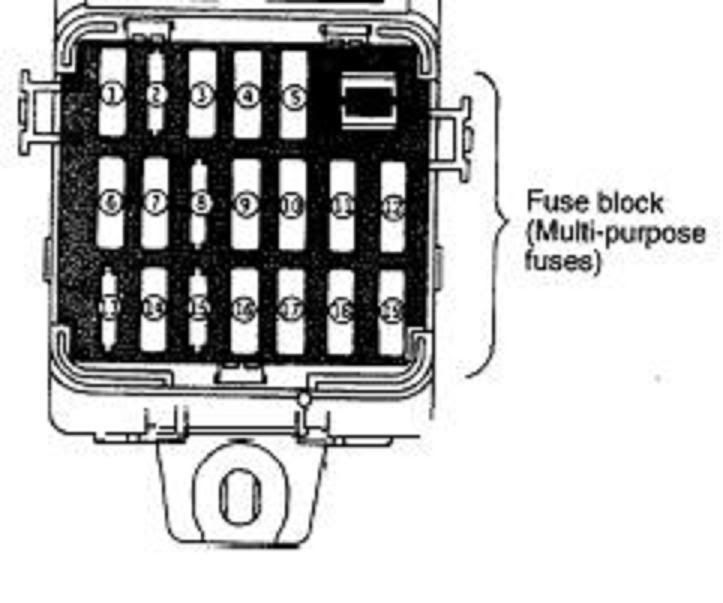

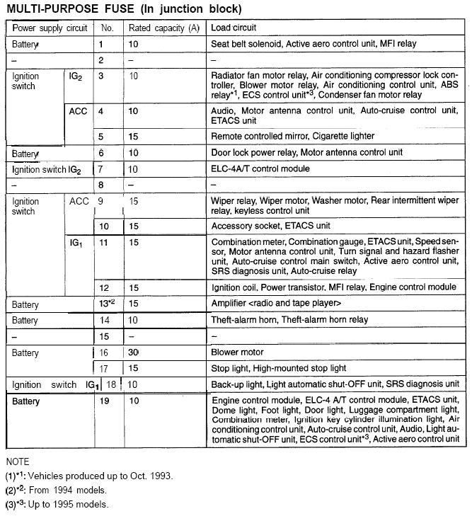

here's some diagrams/illustrations from the service manual for the under dash fuse box.
http://i57.photobucket.com/albums/g236/Linebckr49/3000GT/underdashfuses2.jpg
http://i57.photobucket.com/albums/g236/Linebckr49/3000GT/underdashfuse2.jpg

looks like fuse #5, a 15A fuse, powers the cigarette lighter and powered mirrors.
Igovert500
04-12-2007, 09:30 PM
sweet. Should have looked at the manual myself. I'll swap it tomorrow. I was trying to figure out what else I had lost besides the cigarette lighters...but never thought to check power mirrors..and everything else worked. Thanks
