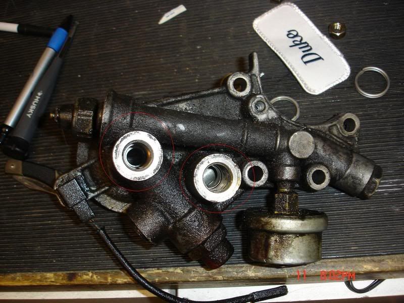

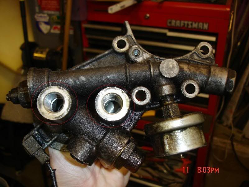

Alright so I got some pictures for what I am talking about...I circled the ports I am talking about but its not showing up too well...
http://i123.photobucket.com/albums/o302/nofx0617/Oilfilterhousing2.jpg
http://i123.photobucket.com/albums/o302/nofx0617/Oilfilterhousing.jpg

Thats right, those are for the oil cooler... You can have a NPT fitting that adapts to AN line and then you can connect that to the 2g cooler lines if you put the correct AN fitting off the 2g cooler lines also... Why wouldn't you just run a normal oil cooler though?
