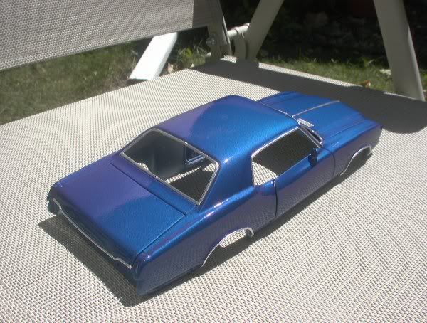

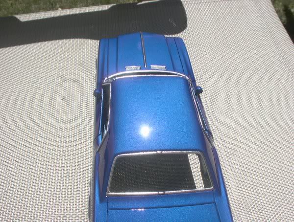

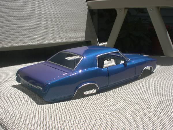

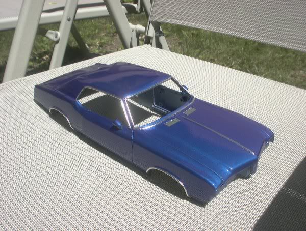

here is a picture of a cutlass that I did with BMF on all the trim.. and arround the windows.. this is a hour after I cleared it.. turned out really nice.
