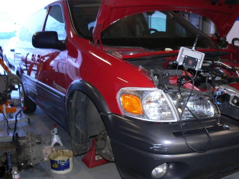

Granted this is a Montana, but this spooks me because its the same engine thats in my Malibu. The intake gaskets were leaking on this one too, and the addition of the coolant appears to have made some neat stuff at the bottom of the pan. Another thing I thought was neat., is there are no oil passages in the front or rear of the motor, only in the center? Who's bad design was this? I never really liked GM before and this stuff makes me really not like em.. :)
http://i59.photobucket.com/albums/g284/thepimpskillet/P1010083.jpg
http://i59.photobucket.com/albums/g284/thepimpskillet/P1010085.jpg
http://i59.photobucket.com/albums/g284/thepimpskillet/P1010081.jpg
The only oil passages are in the center here... strange
http://i59.photobucket.com/albums/g284/thepimpskillet/P1010082.jpg
http://i59.photobucket.com/albums/g284/thepimpskillet/P1010078.jpg
http://i59.photobucket.com/albums/g284/thepimpskillet/P1010080.jpg
http://i59.photobucket.com/albums/g284/thepimpskillet/P1010079.jpg
The main's looked to be more worn then the rod bearings too.. so I guess I'm going to be replacing those when I get into mine too. So a 60-100k ''tune up'' will be an entire top end gasket kit, rod bearings, main bearings, water pump, I would assume the timing chain is ok, but man this thing will be worse than the SHO it looks like... My oil pan in the SHO had never been cleaned and had 181k miles on it.. with almost NO sludge whatsoever... FORD For the win! lol
