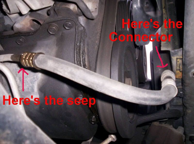

I noticed in the cooler line a big crimped on high pressure hose, Doe's it actually need this big hose ? I have a little seep at the crimp. Can I cut the steel line behind this big hose to add the aftermarket cooler ? Must I use high pressure hose to install the cooler ?

Most aftermarket coolers will come with section of hose so that you can cut and splice where you need. I wouldnt see a problem cutting the hard line, just make sure the rubber line isnt in contact with anything it shouldnt be. Are you sure its leaking at the crimp? The usual leak point is the quick disconnect fitting.
Well as they say, "A pic is worth a thousand words"
http://i107.photobucket.com/albums/m314/Restrorob/JeepTransLine3.jpg
So there's no problem with cutting both lines before the large hoses and routing the new ones through the core support to the cooler right ?

Nice pic.
I dont see a problem cutting that section out and running a longer rubber hose.

Hey Rest...what we usually do in the shop is to grind the swedge off of that hose in your picture and replace the hose.
Then we put worm style clamps on it. If you are paranoid about the hose slipping off, I would put some glue on the pipe (like weather strip adhesive or silcone sealant). Make sure you let the glue dry.
