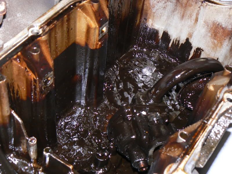

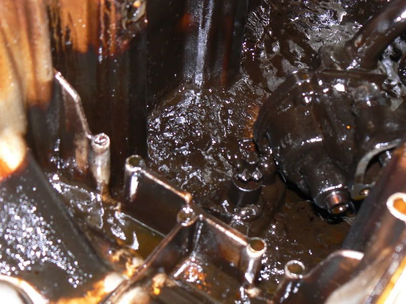

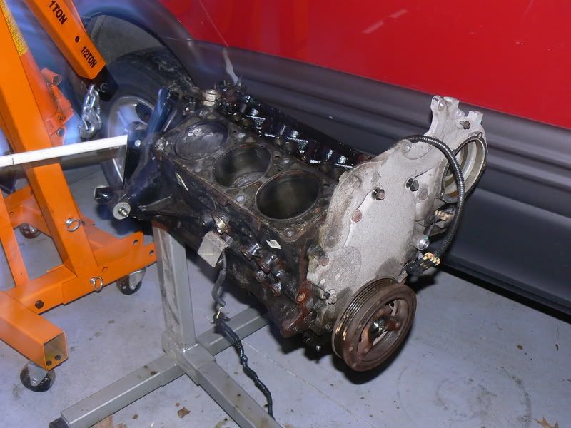

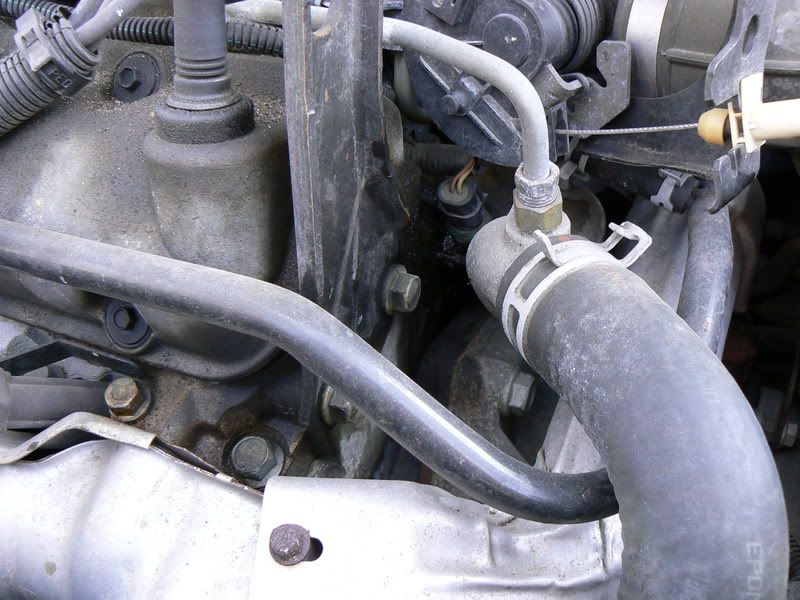

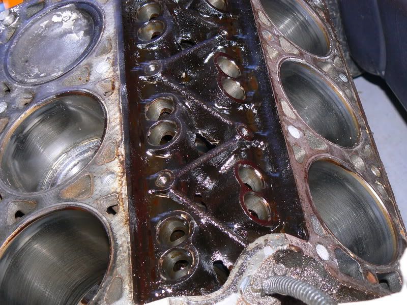

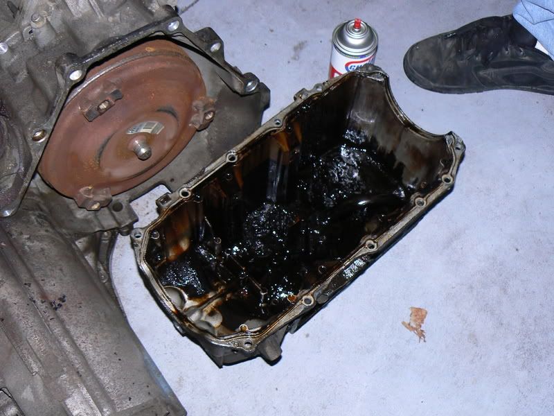

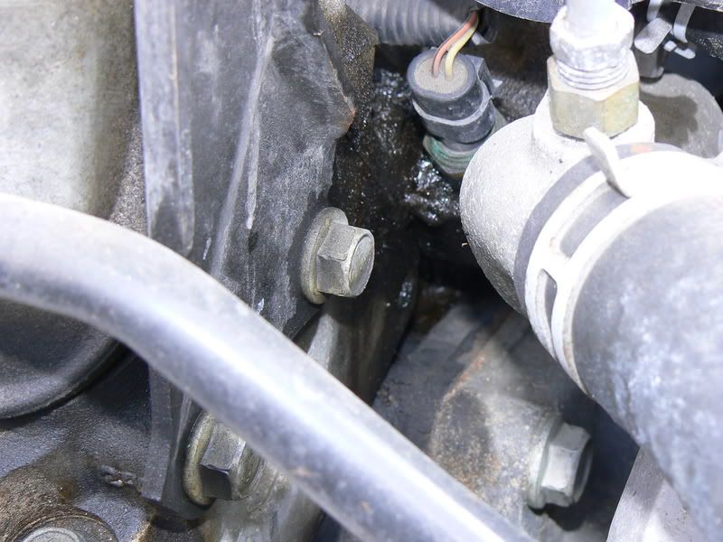

What about the underside of your oil cap. See any funny stuff in there? If you got green snot on the cap of your resivor, which I bet you have, then you're beginning to mix your oil / coolant. I would think @ temp, your motor is squeezing some of the fluid past those bad seals. I gotta do it to my malibu here shortly. But I did see a motor out of a Montana, 3.4 same block / design, and they did the same thing you're doing. Adding coolant to a leak 'for a while'. It cooked the oil down in the pan, and none of that is good. Get a weekend, and do what I'm going to do. Intake gaskets with the new Fel Pro kit, swapping out a new water pump, flushing the old crap out. Then I'm going to drain the oil, drop the pan, clean all that crap out, and probally swap in some new rod bearings. With almost 100,000 miles, it's good preventative maintance. I don't wanna work on this thing again for a while, might as well bring it in for a 'good tune up'. Get a chance to swap the thermostat, plugs, wires all that. Just finished my SHO, now I gotta hack into this Bu.
Slow coolant leak up top leads to this down below!!!
This is where mine is leaking...
http://i59.photobucket.com/albums/g284/thepimpskillet/P1010038.jpg
http://i59.photobucket.com/albums/g284/thepimpskillet/P1010039.jpg
She's been parked since I found it.. Here's that van with the same leak..
http://i59.photobucket.com/albums/g284/thepimpskillet/P1010085.jpg
http://i59.photobucket.com/albums/g284/thepimpskillet/P1010081.jpg
Those odd ball little holes are the only oil return passages, if this area is starved from coolant (pressure loss, because of leak) It cooks. Bad design I think.. anyway..
http://i59.photobucket.com/albums/g284/thepimpskillet/P1010082.jpg
http://i59.photobucket.com/albums/g284/thepimpskillet/P1010078.jpg
http://i59.photobucket.com/albums/g284/thepimpskillet/P1010080.jpg
http://i59.photobucket.com/albums/g284/thepimpskillet/P1010079.jpg
Rod bearings on that motor were almost ready to be changed, and should be, no copper showing yet, but very close. Main's however looked worse, and I wonder how well these things are balanced. ??? Thats why I said I'd rather swap those bearings, if you have coolant in your oil, they are eating those bearings. Fix it right, and be done with it. If you 1/2 ass it my guess is that you'll be back at it again within a year.
