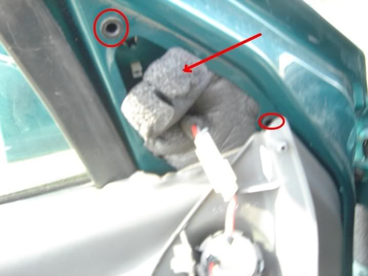

Welcome to AF.
You can do this DIY.
Just pop off the triangle part, with the speaker in it(if your model has one),
right behind the mirror on the interior.

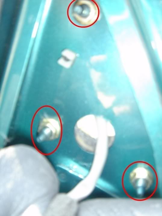

THiers three studs that went into the mirror,
you'll need to remove the nuts on those.
To reach the plug in might be tricky,
but it can be done without removing the door panel.

here is a couple pics....
bezel rem (http://i28.photobucket.com/albums/c242/xeroinfinity/Cold%20Air%20Intake/mirrorrem.jpg)
mirror nuts (http://i28.photobucket.com/albums/c242/xeroinfinity/Cold%20Air%20Intake/mirrornuts.jpg)

Same exact thing just happened to me about a month ago... except it took BOTH mirrors! They are extremely easy to fix and getting one off E-Bay is your best bet.. They go for about $75-85 through a dealership and about $15 off E-bay..... You just take off the speaker on the inside of the door (it just pops off) unscrew the bolts, put the new mirror on, then screw them back in.. replace with speaker cover and your done! Good luck

You guys are the best!! I took the speaker off this weekend to look at it and my friend freaked out because she doesn't want the speaker broken, but I saw the bolts you were talking about and it looks easy. Just a matter of finding the spot where the wires attach and getting the mirror! thanks for your advice!! :)

that plug is tricky.
You'll need a flashlight and a longer screwdriver.
Its about 1-2" below the door panel.
Use the screw driver to release the catch on the plug-in while gently pulling the plug out.
Goes back in much easier.
