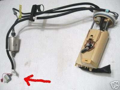

What was the voltage reading with the meter? Part of the wiring to the fuel pump is exposed to the elements and located outside of the fuel tank. Check the electrical connector marked below. Look for corrosion and poor contact. It is located at the rear passenger side of the car underneath by the fuel filler neck area. Also, you can measure the voltage to the fuel pump there.
http://i5.photobucket.com/albums/y186/lizzywiz/aleropump02.jpg

I cleaned the contacts at the fuel pump connections but didn't have a meter to check voltage. Didn't seem to help though, it wouldn't start a couple of days later. We decided to just keep driving the car until it won't start on a regular basis. We are tired of it sitting in the shop for days on end starting and running perfectly 99% of the time.
