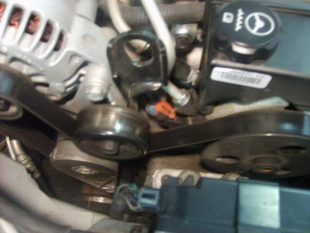

It sounds like this is related to your other post concerning the wiring harness. The electrical connector color coded blue/red goes to the EVO actuator for variable assist steering. The actuator is located or supposed to be located at the bottom of the power steering pump. Most GM N body cars with the 3100/3400 engines come with this option. There are two power steering pumps available.
http://i5.photobucket.com/albums/y186/lizzywiz/evo.jpg

I really don't know which one he has since it wasn't stated in the post Shep. For 1997 the Cutlass was an N and W body. Remember the downsized Cutlass sister to the Malibu was produced from '97-'99. Had he stated it was a Cutlass Supreme I would have mentioned W body. But the pic I showed is applicable to any Cutlass of that year that has a 3.1L VIN "M" and variable steering.

Yes, a defective EVO would cause hard power steering. The EVO actutator is controlled by the ABS module which is commonly referred to as the EBCM module so that may explain the ABS light. It looks at the wheel sensor signal to make the steering either hard or soft. Soft (more assist) at low speeds and hard (less assist) at higher speeds for better road control and stability.
You should be able to get the part at most national auto parts stores or the GM dealer. Also, a salvage yard. Let me know if you need a source for GM/AC Delco parts.
