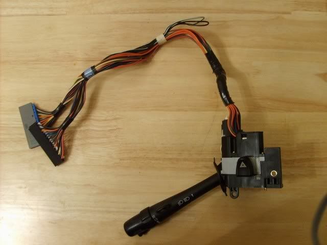

I was just confirming where the problem might be by narrowing it down. In normal operation the fog lights are supposed to turn off when the high beams are on. Safety feature and the fog light relay is de-energized as soon as high beams are on. Looking at that part of the circuit in the wiring diagram and the common areas it looks like the MFS is most likely the culprit. Common problem since there is no low/hi-beam relay in the circuit for protection.
Here is a pic of the one I replaced about 4 months ago. Same problem. No hi-beams. About a 1 hour job DIY to replace.

man that sucks if it is the MFS... i just replaced that with a used one from Morad... My old one, the hazards would not pop up and my cruise didnt work... then i replaced it with his used one and my hazards worked... but still no cruise... where can i get a reliable MFS used because im not about to pay 250 for a new one.
