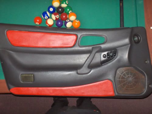

Here's my first attempt on the driver side door panel using red vinyl fabric:
http://i89.photobucket.com/albums/k226/X2Xtreme360/HPIM0607.jpg
I think it turned out pretty nice. This is the first time I've ever attempted something like this. I'll have it installed tomorrow after a little "tack" cleanup.
If anyone wants a write up with pictures when I do the passenger side, let me know and I will. All the materials cost a total of about $15 for a quarter yard of vinyl (enough to do both doors and then some.) and some very strong adhesive.

Looks very good for a first try especially. I wouldnt mind looking into that myself, but I'm eventually getting new two-tone leather for my seats and I beleive it will come with new leather for the inserts.

Looks real good. I may attempt something similar in both the Talon and the Stealth

that did turn out nace man. I'm still just trying to find some way to fix mine since theyre all bubbling. I tried once by using a syringe(sp?) and sucking the air out. It worked but they came back a few days later.
what adhesive did you use on yours?
X2Xtreme360
03-20-2007, 06:31 PM
It's just called heavy duty adhesive. I got it at Joann fabrics. That's also where I got the vinyl.
