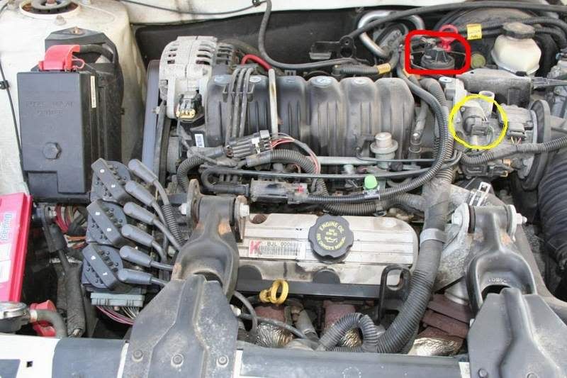

So i have yet to get my scanner, to see what code is being thrown, but my dad thinks that his piece may be bad, It looks like it gets vacuum off the tb, and has a possible fuel line going to it? im not sure what it is, again i come fromt he honda world, but there is a 2 pic harness that gets plugged into it. it chatters kinda bad, sometimes, i have no idea if this is why the car doesn't run great when it heats up. thanks.
Hear is a pic of what i am talking about, i circled the piece in red. thanks

That is the evaporative emissions system purge solenoid. The output vacuum line goes back to the rear of vehicle to the charcoal cannister by the fuel tank.
When bad it should set a DTC of P044X? related to the evaporative emissions system.

I've never known a purge solenoid to cause a bad idle unless there is a problem with the vaccum lines to it. Poor vacuum can cause a bad idle so check all vacuum line connections at the throttle body and intake manifold. The sensor that controls the idle is the idle air controller (IAC). You can try removing it and clean the spring loaded pintle with carb or throttle body spray cleaner. Also, clean the IAC seat throttle body side. The IAC is located on the left hand side of the throttle body. The top round shaped black module with the electrical connector.
Are you geting any SES/CEL light? Also, fuel problems like low fuel pressure or bad fuel injectors can cause a poor idle.
Another component is the MAF sensor.

Yes the Engine light is on. I should have a scanner coming on monday or tuesday to scan it and see whats wrong, or what code its throwing atleast. All Vaccum lines appear to be ok. All that i could find at least. The way the car was running i first that it would be the iac, but was unsure which one it was. On my acura its only a 4 banger, but its on the back of the intake manifold. I will try pulling the iac and cleaning it with carb cleaner. Is the iac what i have circle in red below? http://www.sidewayz.net/olds/olds2.jpg
I took this piece off, i believe it is the idle air control valve, but i dont see a way to open it to clean it decent. Thanks, Chris

That is the EGR valve. Sometimes it can cause a bad idle too so it would not hurt to clean it. Once removed the pintle can be cleaned with carb cleaner. Make sure it moves freely. Then the exhaust tubing part where it mounts on especially at the lower intake manifold.
The IAC is located on the throttle body where the accelerator is connected and the intake ducting from the air filter. Go down about 2 inches in your pic and then to the right. I circled the part in yellow.
http://i5.photobucket.com/albums/y186/lizzywiz/olds2.jpg
The sensor below that is the TPS and to the right, top MAF sensor.

I ended up pulling both pieces. The iac was dirty. I cleaned inside where it seats to. The Egr was kinda dirty, so i cleaned that. Put them back in the car still idles rough, and dies. Its the service Engine soon light thats on. I think im done doing stuff till i get the scanner. Im semi tempted to pull the whole tb/maf off the car to clean it out as best i could and see if that helps. I remember on my Acura the car had to re learn the iac after i put a new one in, but i can barely keep the car running so i dont think i have it yet. I will definatly post codes up as soon as i get it scanned, and thanks for all the help today. Thanks, Chris
