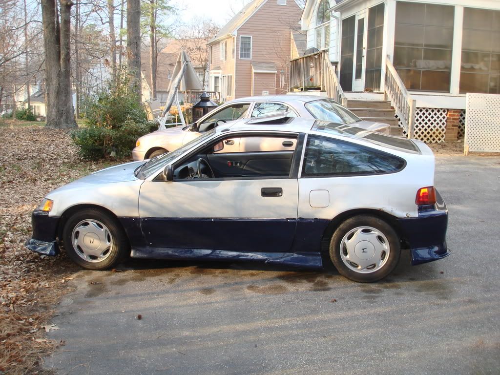

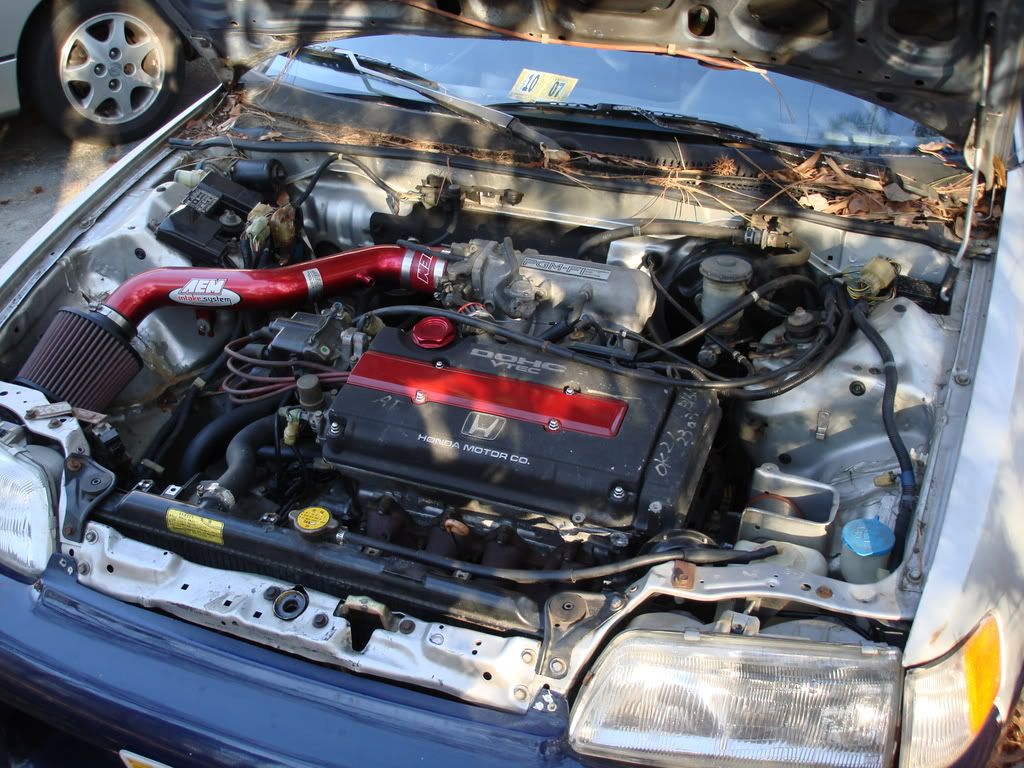

If your looking for a crx swaped i'm selling mine, worth the drive. But I wouldn't boost a b16a1 if you ask me....I personaly would go b18 but if you must have v-tech and you want to boost it, I have a 88 crx b16a1 ys1 for sale.
crxrookie
03-21-2007, 08:52 PM
oh yeah heres some ugggg pics
http://i179.photobucket.com/albums/w310/crxrookie/DSC00242.jpg
http://i179.photobucket.com/albums/w310/crxrookie/DSC00105.jpg
