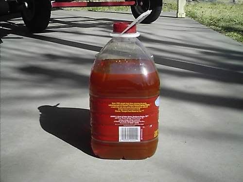

I agree Dex-Cool and air do not get along. That is why the coolant reservoir looks so bad versus what is physically in the radiator and remainder of the cooling system. It is not sealed. I clean mine out every year just to be safe.
Here is the Dex-Cool I replaced out of my '01 Regal GS last year. I went the full 5 years. It looked just as good as the new stuff out of the bottle. I ran a conductivity test with a DMM before draining and there was no reading worth worrying about showing there was high acidic levels to possibly damage gaskets or aluminum.
