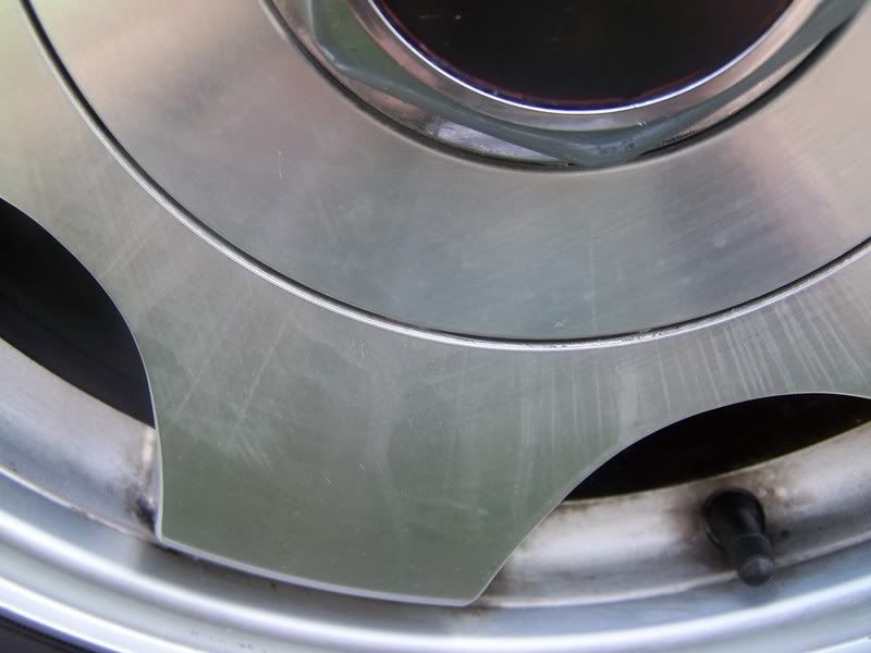

I finally got a pic up on photobucket. I just ran out and quickly cleaned them (with Mothers) to take this pic. (I didn't get into all the crevaces, but it still shows what I'm describing). Like I said earlier, I've tried Prestone, Mothers, and NevRDull with no luck. I switched to Terry Cloth towels and it seemed to improve a little. I previously used microfiber towels...with no luck. Any advice would be appreciated!

The milky streaks are likely damage to your plasticized clearcoat, and they might polish out with a plastic polish. When using a spray-on, hose-off wheel cleaner, it's important to rinse thoroughly so that any cleaner behind the cap gets rinsed away so it doesn't eventually spin out and cause discoloring.
The brown spots around your tire valve and in the tight areas around your spokes are likely brake dust build-up. While it's possible that a little brushing in there with a wheel brush and spray-on, hose-off wheel cleaner might take care of some of it, there's also a pretty good likelihood that there is some permanent damage to your clearcoat.

thanks! I never thought about there being some spin-off from behind the center cap. That would explain the pattern that can be seen in the photo. From now on I'll pop the cap off and make sure it's dry in there as well. Any thoughts about that plastic cleaner? Do you know of any specific ones?

For the clearcoat, I like Mothers Plastic Polish as I think it is a little more aggressive than some of the others I've tried... the wheel coatings can be a tad tough. I've had mixed results.
You might also try cleaner wax, polish or scratch remover that you might already have.
Now that center cap may be part bare aluminum (around the edges), so watch what you use on that so you don't alter (too much) what looks like a brushed finish.

The type of muddy streaking you show can be a bit stubborn, I have found, but hopefully you can make some improvement.

there is no cracking. just milky colored stains as seen in the bottom right of the pic up there

I think those "milky" streaks are permanent... so it's either strip the clearcoat and re-clear (or just keep polished) or some combination.
