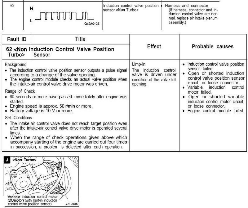

your other code that was thrown, VICS, its a motor on the backside of your upper intake manifold that controls the path of your air in the intake manifold. It allows you to have long runners in low rpms giving you more torque, and switches at a certain rpm level to give you short runners at higher rpms for max hp. If its broken it won't hurt drivability. If its stuck in one position, you'll be giving up the benefits of the other position. Look on the back driver's side of the intake manifold, you will see where two wiring harnesses plug in. Thats where the motor is.

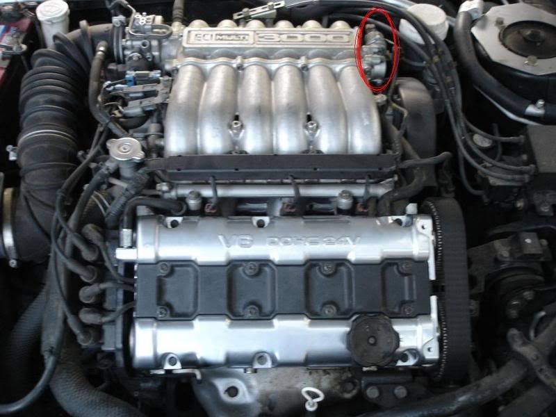

its actually on the driver side of the intake plenum, on the exact opposite side from the throttle body.

I am going to check the connectors on the inductive con something valve position sensor code 62.
