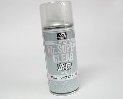

Antbody know if this is laqcuer,enamel, acryl or what? I bought some a while ago but never used it. Can i spray it over Tamiya TS sprays? How does it react with decals? thanks

It's synthetic lacquer-based acrylic paint, essentially the same as Tamiya's TS sprays.
leokc_ng
03-12-2007, 08:34 PM
Becareful when apply Mr Hobby/ Gunze spary can over Tamiya's paint.
As Mr Hobby/ Gunze lacquer thinner are much stronger than Tamiya thinner.
Tamiya paint would dissolve in Mr Hobby/ Gunze thinner easily but not the other way round.
If you need to apply this clear coat on Tamiya paint, be patient and apply thin layer each time. GD luck!!!

Yep, be careful with it and wear a mask!!
I used this for the first time on my Daytona. It's a great clear - dries very hard, very quickly with a great shine but it is strong, so THIN coats at first.

As I found out here (http://www.automotiveforums.com/vbulletin/showpost.php?p=4435339&postcount=1) this stuff is strong, so like everyone else said.. be careful...
