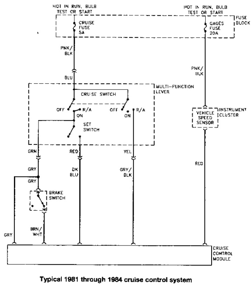

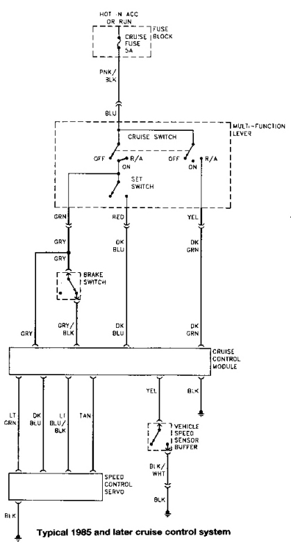

does anybody have a wiring diagram for the cruise control on an 84 caprice?
i've determined its an electrical problem, but my attempts to sort it out are futile without a wiring diagram.
thanks

I will have one here for you later tonight. I have it but I have to scan it and I am about 10 minutes away from an appointment at the dentist for a damn cleaning. I hate those. I always want to eat a hamburger afterward.
silicon212
03-14-2007, 07:26 PM
As promised:
http://www.silicon212.org/cc1.jpg
http://www.silicon212.org/cc2.jpg

thanks a lot. the colors dont seem to match up, but i guess the positions and whatever are the same.
if i remember, the blue was always hot.
oops, i almost forgot...
thank you.
