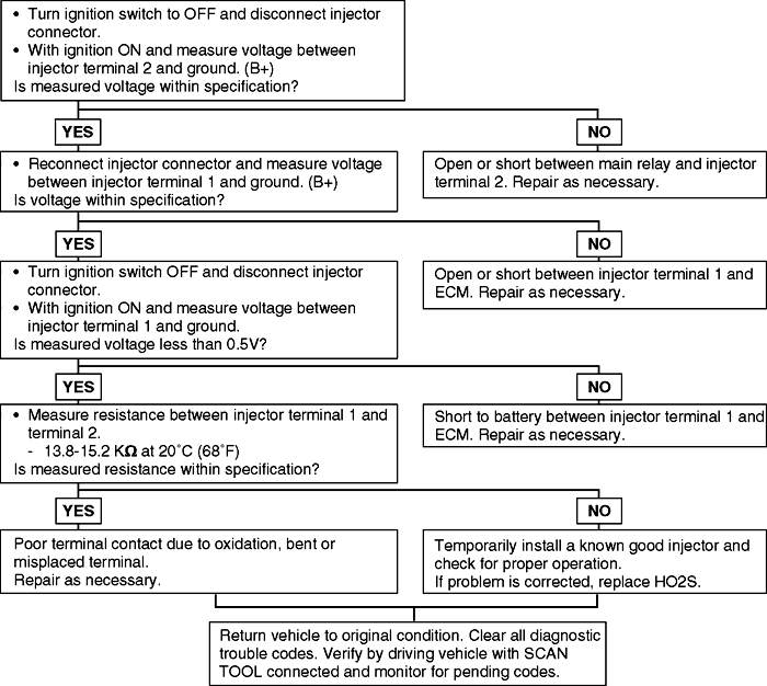

You need to be looking at the cylinder 5 fuel injector before you mess any more with the ignition. The P0274 is likely causing the misfire code. Here is the flow chart for diagnosing P0274, and any injector high or low resistance codes.
http://i101.photobucket.com/albums/m52/jjnance/Work%20Related%20Pictures/efac612a.gif
