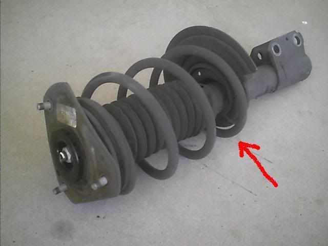

To do the job right you should replace the upper strut mount/load bearing especially if you have some mileage racked up. See pic below for that plastic bellows and bumper stop. It is a separate part(s). The bumper stop is fitted to the bottom part of the plastic bellows cover.
