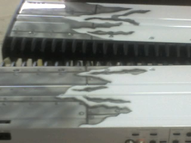

if you like slash amps check out wat we did at the body shop
http://i146.photobucket.com/albums/r275/dbmagic/img065-1.jpg

i wouldn't have painted them beause the case acts as the heat sink
dbfreak147.5
03-07-2007, 07:25 PM
actually the fins on the top and bottom of those amps act as heatsink, not to mention airbrush and a little bit of clear isn't goin to throw that amp off

back in the day (late 80's - early 90's) most people painted their amps to match or compliment the car paint scheme. I doubt it would seriously effect the cooling, most amps are painted or anodized anyway.

IT cant be that bad for it, but there is an idiot down here that had started ceramic coating everything in his engine bay with some rattle can crap. He thought it would be a good idea to put 3 coats on one of his rockford amps, that he had under his seat. Well needles to say the amp never stayed on for longer than 10 min after that.
