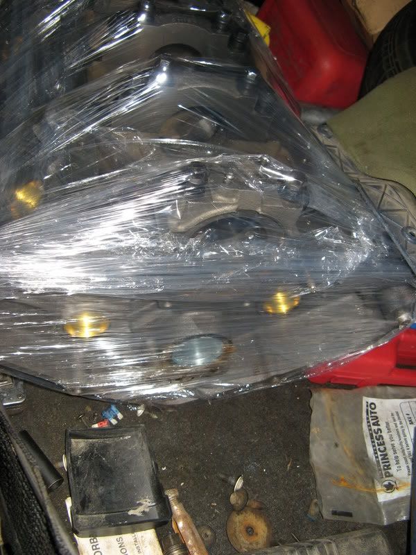

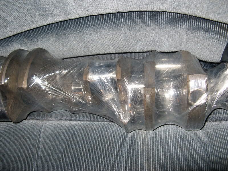

well its back from the machine shop, 97 vortec roller block, roller cam, aluminum heads, punched it 0.030 over , speed pro forged aluminum pistons, PM rods with arp bolts and a whole lot of other parts!

Looks sweet, other than the timing chain.

So, what size engine is this, how much Hp do you plan on making, and what is it going into?

that is a pretty skimpy looking chain. a dual roller really doesnt cost much. it sounds like you making a good amount of torque. you might consider an upgrade (easier done now than later).
looking good! what do you have planned?
keep us updated.

i need a special chain since im running an OE roller cam, different than the regular flat tappet timing chain, that thing i have is a MASSIVE single roller which gm used and is suppose to be very strong, as most of the ndouble roller for a OE roller cam block are quite expensive and this was free(still brand new) btw its going into my 86 camaro

its a 350 bored over to 355, i wanna see roughly 450hp at the crank

looks good, are you gonna have it balanced as well?

already been balanced you can see the holes the welded up in the crank, cost me $200 fricken bucks too

You Canadians... :screwy: Take the plastic off the engine next time you post pics, Babs. :disappoin That thing might as well have been a freaking Twinky from what I could see of it. :rofl:

^^^somebodys hungry, ive got pics of partial assemnly but my dam computer wont read my dam camera

nice, the look of an engine wrapped in plastic from the machien shop is strangely familiar to me lately
